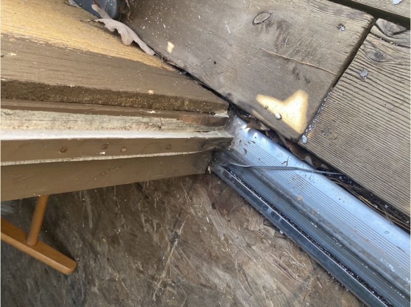

My door is leaking at the threshold. Rain hits the door, runs down and comes in. The problem is the threshold is 5/8” tall and my gap is 3/8. So the gasket is smashed and not functioning properly.
I had a steel exterior door, so I just framed the wall to hold that door, not a pre hung. Then made the jamb myself. The jamb needs some attention, but need to solve the threshold prob first.
The threshold simply sits on the floor, and There’s a drip edge under it so the floor isn’t exposed to the elements.
Door
Door

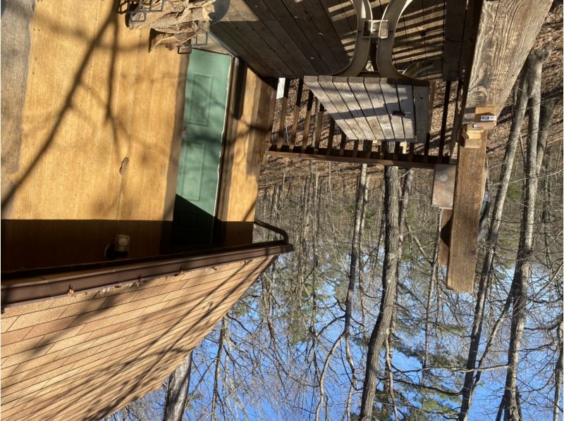

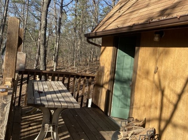

# Posted: 16 Nov 2020 11:41pm
Here’s a better pic. One problem is the door opens in because of the roof over hang. So the jamb is exposed. I’ve seen some pvc jamb kits, or maybe I can cut down some pressure treated boards.
After a bit of research it dosent look like there are any thresholds that are shorter then mine. I believe it’s 5/8 tall. I need more like 3/8. Maybe I can cut out the floor and set a 1” threshold on top of the joists?
I built the deck to hold a 6’ wide piece of roof over the door. Guess I need to get to that sooner or later.
Deck
Deck

# Posted: 17 Nov 2020 08:02am
Rotated.
mattd
# Posted: 17 Nov 2020 08:07am
Thanks! Couldn’t figure out how to post it right side up.
King stud, Jack, header. It’s just obscured by the shadow of the roof.

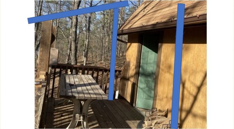

# Posted: 17 Nov 2020 08:10am
Cover added to keep rain away from door.

If I have a header on the Existing porch posts, on the left of the pic. And tie into the roof rafters on the other end, would I need posts near cabin? The verticals in your pic.
Alternatively, there’s a loft inside. I could maybe do a load bearing knee wall.
# Posted: 17 Nov 2020 09:49am
Generally a overhang like your trying to build is best when the roof rafters are put ontop of the top wall plate. So no post at the cabin wall is needed.

# Posted: 17 Nov 2020 03:32pm - Edited by: DaveBell
What is the length from the deck floor to the top of the porch posts in the picture? What is the length from the deck floor to the bottom of the gutter?
# Posted: 17 Nov 2020 03:42pm
When you put a long level on the deck, from the door towards the table, does it slope outwards, slope towards the door, or level? If it does not slope outwards by say 1/2 bubble, you may need to cover the whole deck. I see leaves jamming up between deck floor boards at your door. You may have three problems: driving rain, rain splash, and rain flow over the deck floor to the door and wall. Since the deck is near level with the barn floor, you may want to pull up the deck boards along the wall and cut one inch off long ways to allow water to fall before it hits the door and wall.

In the first picture, the deck boards look a little higher than the threshold.

Can you replace the bottom/floor gasket somehow? I had a similar problem with a new pre-hung door. It turned out rain was making its way behind the gasket on the hinge side of the door, running down the inside of the frame through a sponge-like gasket at sill-level, into a small gap between the sill and the door frame, and onto the plywood subfloor. It took me a couple of times to figure out how it was happening, and I was able to fix it with a liberal application of caulk.
It's slopes away, might not be as much as half a bubble.
There is a small gap between the deck rim joist and the deck board, but leaves are an issue. I agree with your 3 problems, and the solution. Had a pretty major table saw accident this past summer and still dont have the nerve to go back to it. Long cuts with a circle saw are always fun!
This is exactly my issue. my original inquiry was if anyone new of a shorter threshold, because that rubber gasket is getting too smashed. I've gone the caulk at the corners route to solve that issue, and i could replace the rubber gasket, but there are obviously better solutions.
