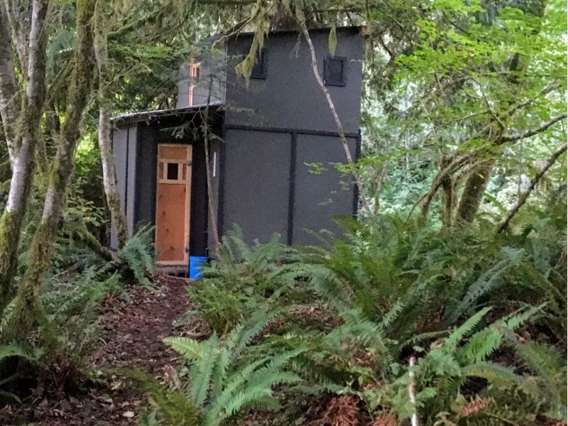

Greetings. I have a small recreational cabin I built by myself next to a waterfall on the edge of a cliff overlooking a river in the Olympic Rainforest. I have no building experience or knowledge at all, so everything was done by trial and error. It's small enough that I didn't have to worry about permits or codes and it's totally off the grid.
The main part of the cabin is 8'x8', two stories. The second floor has a corrugated metal roof (I love the look of it) that I attached directly to 2x4s. It's strong and secure and looks beautiful and my cabin is wonderful and everything I've ever dreamed of. I absolutely love it!

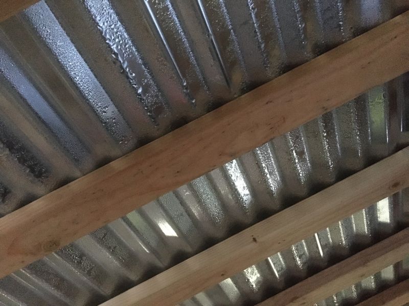

But, now that it's colder outside, the roof has developed condensation issues. I've done some research and discovered I built it wrong, should have put OSB underneath it, etc. etc. etc. I can't go back and undo my errors; I need to figure out how to fix it. What would be the best way to deal with this? I'm thinking about installing rigid foam insulation boards between the 2x4s, which are spaced roughly one foot apart. And then maybe a plastic vapor barrier under that or running another thin sheet of rigid foam insulation under the 2x4s and rigid foam.
Would this work? Do I need to have ventilation holes and where would I put them? Along the insulation layer? Or underneath in the main cabin area? None of the cabin is insulated yet, in part because there really hasn't been any need, and also because of limited resources. It rarely falls below freezing, and my little propane space heater does a great job.

One of the great things about metal roofing,is yes you can actually remove it and re use it ,so climb up there ,unscrew it ,do what you need to do ,and screw it down afterwards .You can’t do that with shingles .
# Posted: 16 Nov 2020 06:38
Yea I would remove the roofing and start over. 2x4s layed flat like that for rafters is not a good idea. Theres no strength in them layed down. If your useing them as strapping that's fine.
I would remove the metal, put down foam board then strapping.
# Posted: 16 Nov 2020 07:58
Remove metal roof, install a good plywood underlayment, dont use OSB, use real plywood and then a good 30# felt layered to shed moisture down and out, screw the roofing right back down.

Going to mention that I have had several garages with what is commonly called double bubble foil insulation. Love it! not much insulation value but it keeps the interior as cool as ambient temp. and stops condensation. Still have to pull the roof off but it can go against the roof itself and will have a white side facing interior.

You could use closed-cell spray foam insulation directly onto metal roofing. You can purchase DIY kits. For example: https://tigerfoam.com/sprayfoaminsulation/order-products/spray-foam-kits/ -OR- http://www.sprayitgreen.com/

Update: I went ahead and hired a professional roofer. We removed the corrugated metal and installed OSB decking, 2" foam board insulation, roof felt, furring strips, and then reattached the original corrugated metal over the top of all that. It's now well insulated and I shouldn't have any issues with condensation now. Thank you for all your comments! I learned a lot.
