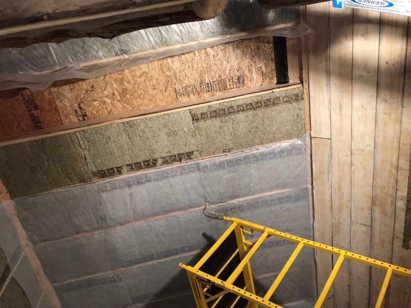

They do make a batt insulation specifically for cathedral ceilings. Rockwool R30, fits in 2x8. I used this insulation in my 2x10 rafters as i needed an airspace to vent. Works well.
https://www.lowes.com/pd/ROCKWOOL-COMFORTBATT-R-30-Stone-Wool-Batt-Insulation-with-So und-Barrier-23-in-W-x-47-in-L/3693532?cm_mmc=shp-_-c-_-prd-_-bdm-_-google-_-lia-_-102 -_-insulation-_-3693532-_-0&placeholder=null&gclid=Cj0KCQiAhs79BRD0ARIsAC6XpaWu69NBIf _oUVODSdqVJ3mR60VzHdMzkC2lOTpde2Kx8nnX44CiwLMaAssKEALw_wcB&gclsrc=aw.ds
