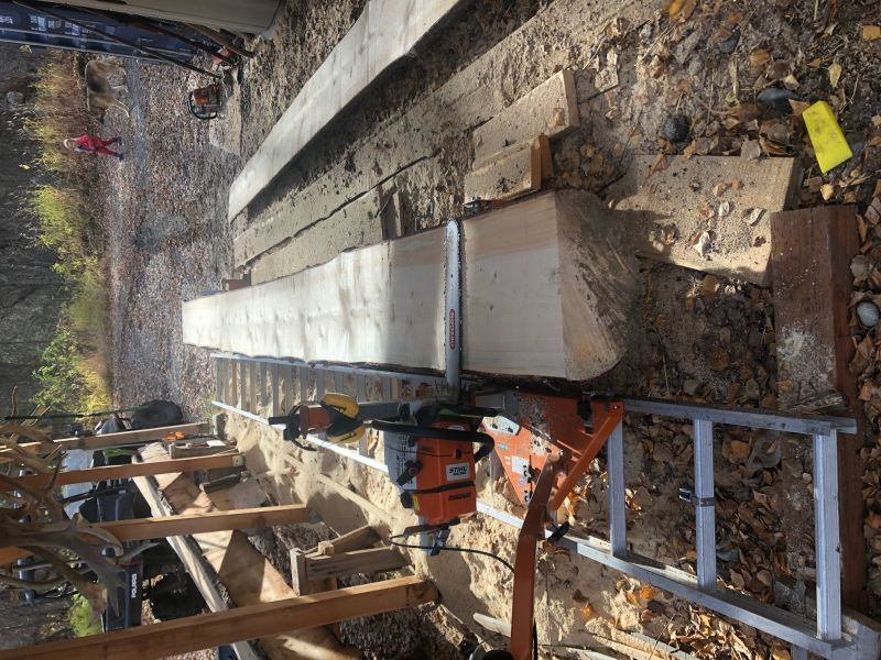

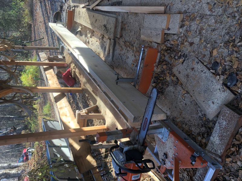

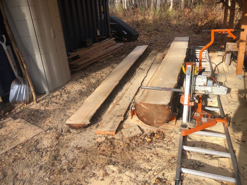

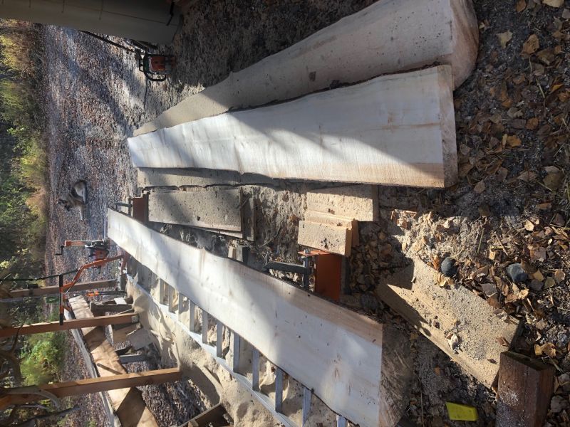

I have used a few chainsaw mills. The Granberg edging mill is great for slabbing logs. The Alaskan mill you can make boards and what not. I upgraded to a Norwood PM14. Chainsaw mill that runs on a rack system. ergonomics are much better then the Alaskan mill.
Pictures of my Stihl 660, ripping chain, 20" bar cutting 18" wide spruce slabs @ 17' long. I have milled birch and spruce. 660 has plenty of RPM's and power. Defiantly have to have a milling chain. Milled all my indoor trim, stairs, treads, etc with it. Mill_1.jpg
