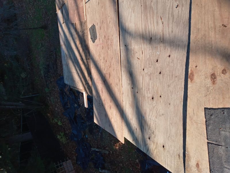

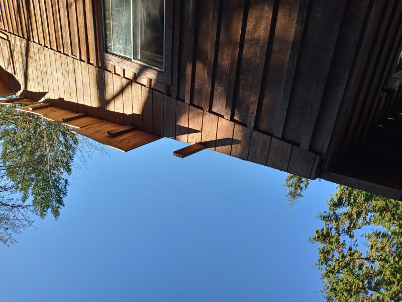

# Posted: 29 Nov 2020 03:02pm - Edited by: pedersjo
There is an attic in the roof, which goes from flat to 5'. Would you vent at the ridge? Here are two photos. I'm sorry, one is upside down. Just noticed that after the upload.
