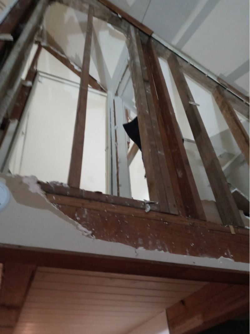

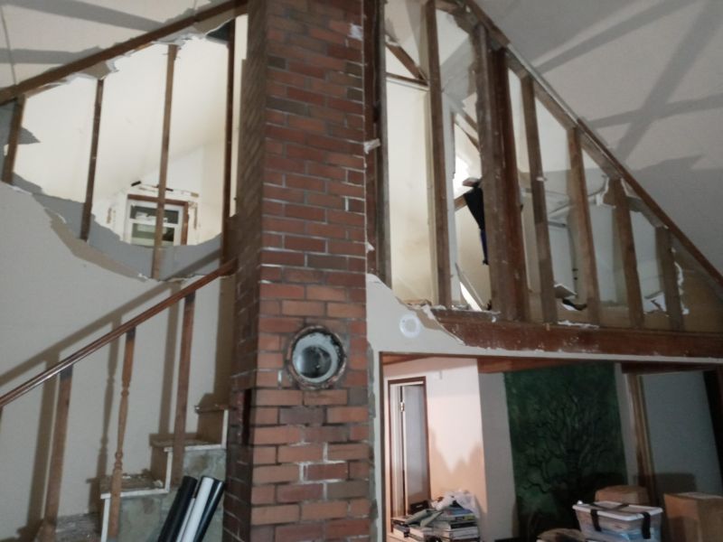

I have been trying to get someone out to look at this, to answer my question. They want between $1000-$1200 to do so (it is a long drive). So, I thought I’d ask. Just wanted to knock down the upstairs room wall and open it up to the living room. Is this wall load baring, would it be safe to remove some or all of the studs? I do want to keep a few, like the one that supports the stairway of course.

Hard to tell for certain from those photos, but it looks like there are multiple studs in the center (next to the brick chimney), and another multiple-stud spot on the right in the photos. I certainly would be reluctant to pull the one next to the chimney, as it could easily be load-bearing. I suspect the other one may not be load-bearing because of it's location (perhaps original framing for an interior door?), but one would need to know more about the overall structure of the cabin, particularly the roof, before pulling that out.

Those 2 photos can not supply enough info to do anything other than guess. To determine what is what, one really needs a personal inspection or a look at the plans that were used to build from. The load path from roof down to foundation needs to be verified for starters. Hence, the thousand dollar estimate.

5 studs together like that leads me to think it’s bearing a load.

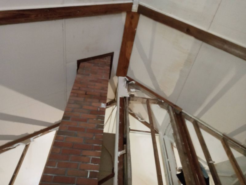

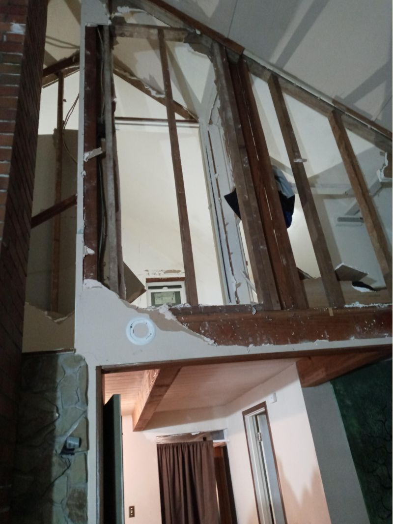

Here are two more. I live one hour outside of town, in the mountains. They want travel time pay (there and back) and want to do a house inspection, quoted me $1100. We are sort of on a budget, retired and I am doing the work myself, it's just a wall. However, do not want the roof to fall in . If I could remove a few studs even, I could make look nice, put a rail up, and stuff.

Looks to me like the stud next to the chimney is supporting the ridge beam. Goes all the way to the ground.

How about you treat it as a load bearing wall and re-engineer it to have support but with fewer, thicker uprights rather than just a stud wall. It would have better eye appeal and you could rest easier not wondering if/when it might fall in.

The 5 studs together looks more like a lazy frame to me. Esp now that I see theres nothing under it.

Your right. It does look a bit bent but it could be the camera. I also dont see a beam above the 5 studs but that could be hidden in the drywall. If no beam above it then it's really just holding up one roof rafter and not structural.

Are the 5 studs part of a doorway framing? It appears to be a door frame and if so, two of those studs are primarily there as drywall nailers. As Brett says though.... if there is a beam hidden in the drywall above....

The roof material between what looks like 2 walls is a small piece. Could be cut around out and replace easily. And give you a good look at what is there.

Whats inside the sheetrock on bottom floor just to right of chimney, is that a load carrying support? Does it go down under crawlspace etc to a pad?. Could a support be holding up center of ridge? If that is the case, you could keep it in place while removing the rest. But you still need a builder/pro to put an eyeball on it.

Yes, that goes down below the floor. It has to be supporting the ridge beam. The others stop on the upper floor. The other side of the chimney looks to be just supportive. As I wrote, certainly do not mind keeping some of the studs, would just like to clean it up a bit. I'll call around some more and see if I can get someone out here at a reasonable cost. We are too far out, that's the challenge with having a cabin in the woods I guess. Thank you for your response.
