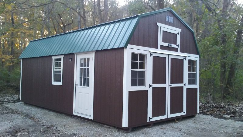

I bought a prefab shell that was sold as a shed or garage but it was not the type you see on the roadside. I special ordered it to my liking with house doors, insulated floor, 2x6 walls, etc. if I had to do it again I would do a few things different but I would still get the prefab. It allowed me to be weather tight day one and it got me around some of the towns permitting rules
# Posted: 15 Dec 2020 04:56pm
This is 12 x 24 with a loft on each end.

We have a prebuilt 10x16 shed with loft, the kind you see on the side of the road. When we had our red pines thinned, we used the proceeds to pay for the shed.
You will be told that you CAN use something like that IF it meets code. It will not, of course, as they are built for the most part. I doubt the 2x4 rafters would be OK, but more importantly, probably will need egress sized windows or a 2nd exit, and proper anchoring of the thing to the ground. But I got the impression there IS a way to get the local inspector to approve those.
Upsides: Instant building, not a ton of work on your part, and customizeable a fair amount, actually.
Downsides (at least based on our shed, or one's we saw Substandard lumber specs for lofts or rafters. Single pane windows. No flashing or real water management, so we're getting water staining coming in around the door trim on the floor. Not 100% bug tight or rodent tight.
Vapor barrier: Don't worry about that fact right now. Can be added. Insulating walls and roof is doable, but I think the floor would be a tougher ordeal.
Skids: I think you'd have a tough time putting one of these on columns. Basically a small vehicle needs to be able to slide the shed into place somewhere.
Based on my experience with having a shed, if you were to get one to stay in, I would think this type of structure would work for 5-15 years, but I wouldn't want to count on it to last the rest of your life, or be worth/easy to maintain beyond a certain point.

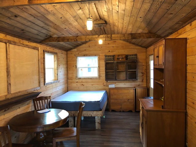

Ours is a pre-built "shed". But company would let you order what you wanted- including built to home code. It added some $ but for us it was time vs. money vs. labor. https://www.pineviewbuildings.com/products/series/dutchlap
In NC, 2x4 walls are fine, not that cold here. Ours is on blocks and strapped down to ground. It was pre-wired with 4 outlets, I added 2 more myself. I did insulation other than floor, had them spray it when built. One good thing about ours, it was never wet inside- They build them in warehouse. Ours is 12x20.

Size is 12x24
And it's built with 16'OC walls and rafters, 2x6 12" OC trusses, PT runners and 3/4" floor, 2 9 lite insulated doors, spray foam insulated floor, metal roof... all for $7500 delivered and set up
With me doing interior fit up ( including adding 4 insulated window), having 2 porches built on it, adding solar with lithium battery.. I think I am at around $16-17,000. Building was purchased on 5/16/2019, delivered on 6/03/2019, me working on it 2 full weeks and every-other weekend in summer...
We had Thanksgiving there last year and only did not have porches on.
So yeah it worked for us ( we have 2 other folks with like kind of "cabins" there)
