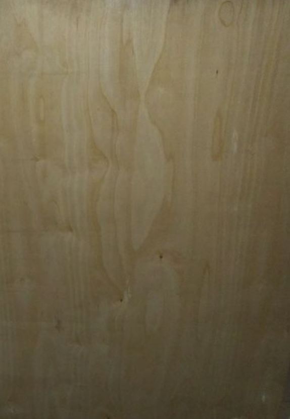

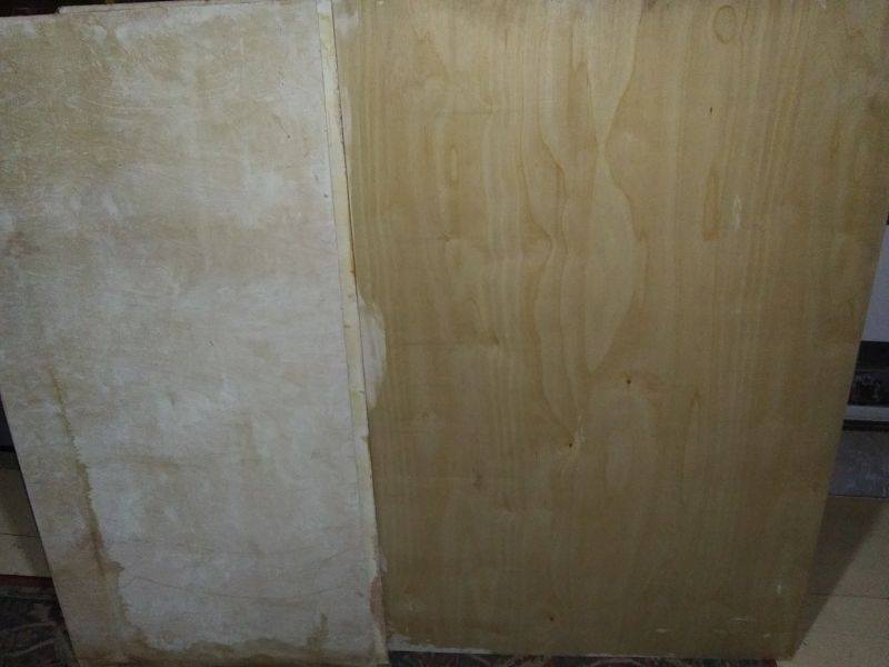

Going to finally, 5 years later, cover the studs and insulation in my cabin. Last summer I went to get some free plywood (remember those days?), leftover from a big buck tech display at Burning Man. Also being given away was lots of this 3/16" veneer paneling. I'n not really picky about looks since just about every square foot of the walls has something in front of or hanging from it.
On the left is a piece complete with Burning Man desert dust, on then right is wiped down with a wet reg.
What are the cons of using this stuff? I know the fire protection of sheet rock isn't there. The grain would need to be vertical I guess, meaning battens every 4'. I would prefer to stain or oil it as opposed to painting. Hanging a picture would require some kind of fastener.
Show me any photos if you're done wood paneling.

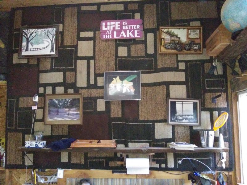

Well Paul, you could do like a friend of mine did years back, he salvaged any decent carpeting he could and just kept layering it on the floors of his drafty old 100+yr old farmhouse. He lived on the first floor sandwiched between the carpet upstairs and under his feet. Ceiling kept getting closer though....
Cover your walls with whatchagot now and add to it over time as better comes along?

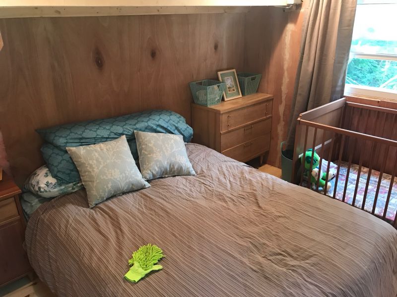

I used the same stuff on the last one I built, it looks good.

You could put the plywood on first and then put the paneling over that, then you'd have a substantial wall.
Paneling unsupported directly on the studs is asking for trouble, been there fixed that.
Burning Man dirt is high in alkaline. Try something acidic like vinegar to see if it removed the dirt. Rinse and dry. Also try CLR.
Lol, that's what I've been doing. Carpet on one wall, some mirrored closet doors on another, whatever will hang on a nail.. Actually I will miss having the blocking and studs to keep stuff on.
Looks great, great color too. I was thinking of leaving mine a light color for room brightness but yours looks much richer. I have a couple gallons of stain around here somewhere i need to test.
The exterior is sheathed in 1/2 plywood with board and batten over that, figured that was enough sheer? Cabin has been stable for 5 years so far, actually more than I expected since it floats on pier blocks.
Good idea. Seems to wipe off easily but who knows how a finish will react.

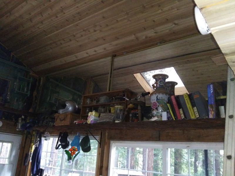

OK I'm convinced to go light color, maybe even clear or white wash as Nobs suggested. My ceiling is cedar T&G, no stain, in photo above. Did that a couple years ago, got a good deal on it, natch.

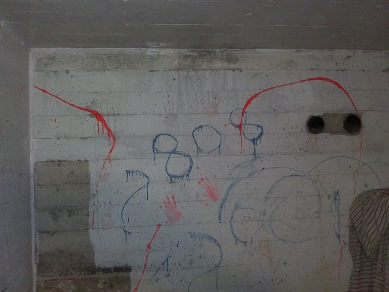

Thanks, I like the water base idea. My paint philosophy, having just painted my bomb shelter this week, is get the shit on there and get it out of your hair, clothes, shoes and anything else in the way later.
Do you put that water base on with a brush or roller, thick like, or just wipe it on with a rag?

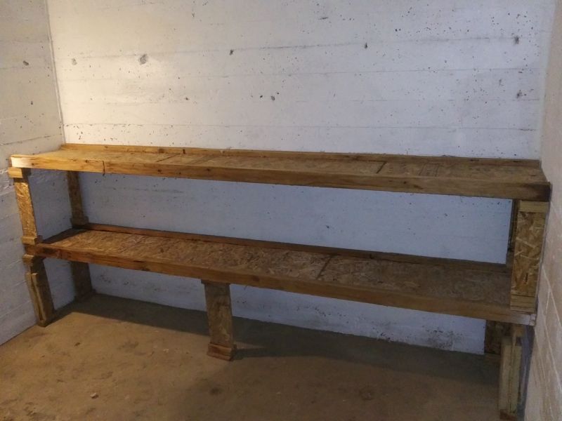

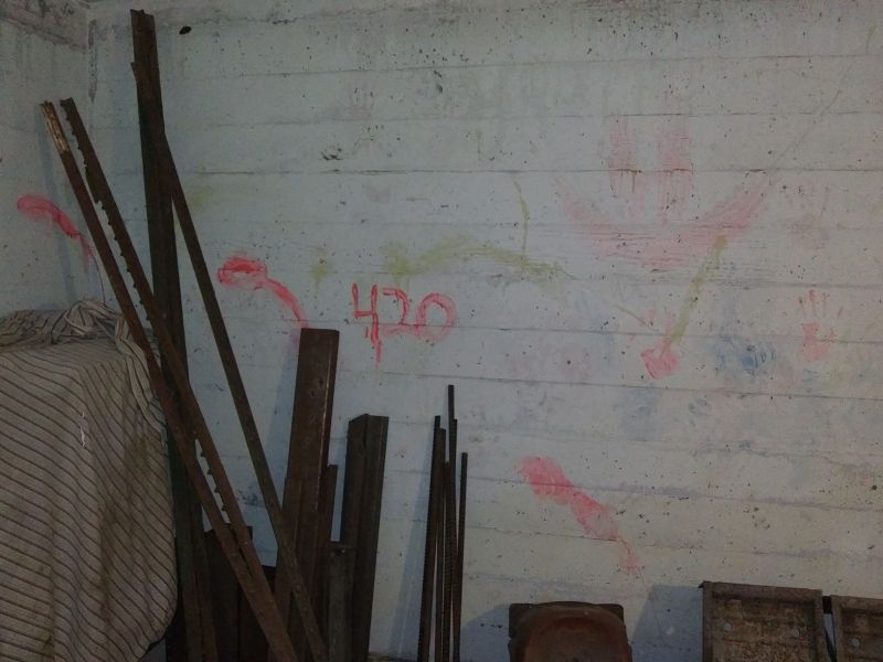

Here's the bomb shelter. 9" concrete walls. Next weeks project, shelving made out of leftover I-joists.
