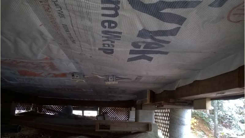

I stapled Tyvek underneath to hold the insulation up neatly, and then used roofing nails to hold the metal mesh up overtop to keep the rodents out. I'm happy with how it turned out, and have had zero critter issues, on our 3rd year now. TSC has that metal mesh (1/4" square is what I used), on sale for half price every one in a while.
WILL1E

Quoting: rpe
Any issues with moisture since your barrier layer is on the bottom?

# Posted: 1 Feb 2021 09:20pm
Quoting: WILL1E
No issues. Tyvek is breathable, not like vapour barrier. In fact, I read somewhere it was first designed for under-floor application, and later used on exterior sheathing.

rpe So you just have unfaced batts between your joist resting on that tyvek and metal mesh? If so, i assume you installed those both from the underside first and then put the insulation in?
rpe
# Posted: 2 Feb 2021 10:59am
Quoting: WILL1E
Unfaced Rockwool R24 batts were used. This was all installed after-the-fact, from underneath (~18" clearance at a minimum, often 3' or so). In most bays they held themselves in place on installation. In a couple bays where the joist spacing was a bit over, or maybe twisted, they had a tendency to sag and drop out as I was installing them. I just tacked a nail or two in to hold up teh saggers as I was going, then quickly followed up with Tyvek stapled onto the underside of the joists.
Another guy in my area did a major reno on his cottage, including pulling up the floor right down to the joists. He previously had no floor insulation, so he spray-foamed it from above! To provide a backer at the bottom of the joist bays, he nailed those little metal angles (used for supporting hanging ceiling panels) along the bottom of each joist, and then dropped in strips of 1/4" plywood to form the 'floor' at the bottom of the joist bay. Then the spray foam guys shot the bays full of foam from above.
