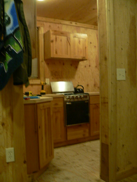

Ok, I installed my custom cabinets last week, built my counter top (formica and backsplash another weekend job)
Got the entire cabin trimmed out, woodstove pipe installed, stone work trimmed out, built bunks and pantry (both in the same room) plumbed in my gas oven/cooktop. Trimmed out attic and crawlspace doors, plus added a weather seal on them too.
Getting much closer to completion.
Looking through the kitchen from the main room

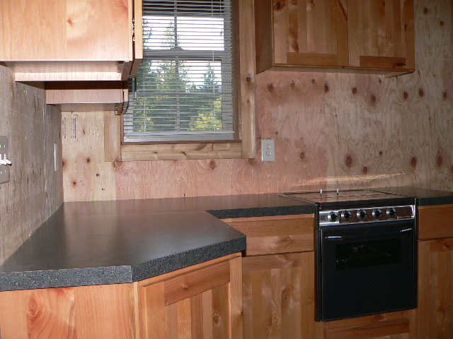

Kitchen cabinets
Kitchen cabinets

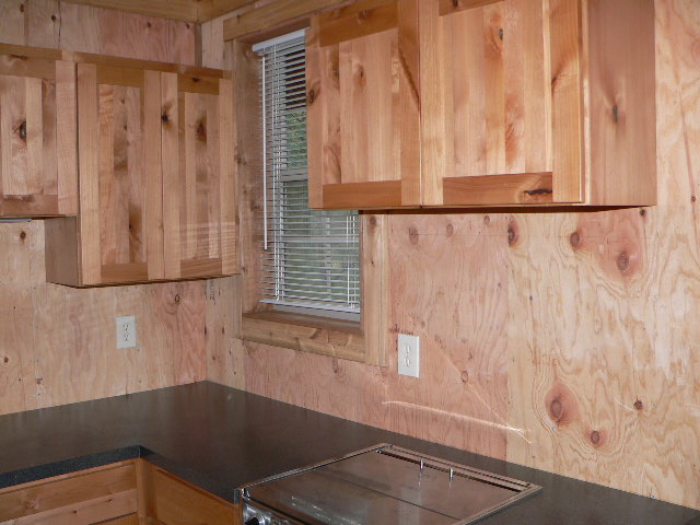

Wall cabinets
Wall cabinets

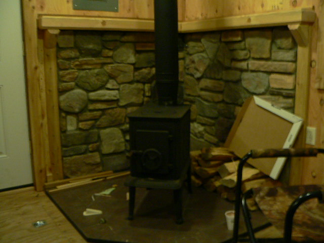

Woodstove installed and trimmed out

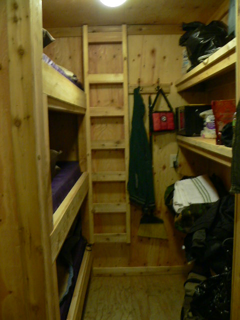

Bunks to the left, pantry storage on the right

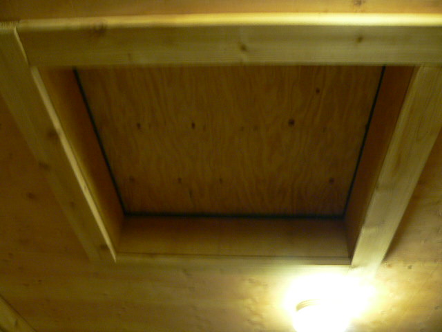

Trimmed out attic entrance

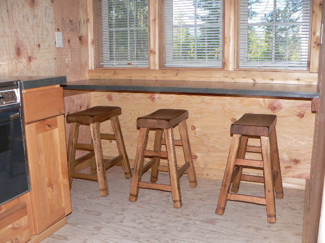

Dining counter. Will also get the same formica treatment.

Looks nice...... How are you gonna finish that plywood?

The cabins footprint is only 16 feet wide, and 18 feet long. But its not a square, it has the covered porch. Inside square footage is 236 sq feet, add porch, its 288. As for upstairs, its all open and I did sheat the top side of the ceiling joist just to make it easier for me to build the roof (walk on a flat floor vs across 2X6's) but this cabin can be build with an upstairs. Its just a matter of peeling off the roof, building it with a steeper pitch and adding a pair of dormers on each side. I already ran a power wire (romex) cable up there. But I doubt I will ever add a fully functional upstairs, its just attic and plenty of storage that is getting heavy use.

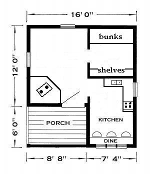

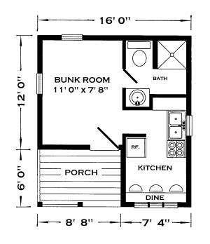

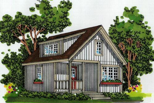

A few photos of the original floor plan, then the way I built it. Noticed I moved the stairs to the side, i was on a slight incline and plus the parking in the front or back, it made more sense to have the steps on the side. I moved the rear window more ot the center, and straightened out the wall between kitchen and bunkroom.
Mine, just a smidge steeper roof
Same as mine, but upstars model.
Original floor plan
Original floor plan

I wil bring a belt sander, sand off the labels and stamps, sand it smooth and then put a finish over it. I may let it age naturally for a while and darken. Then seal it in. I have seen plywood finished and it appears to look like knotty pine.

Geez T-tech, I just realized your walls are still the plywood you'd questioned using or covering at the outset. The knots sure blend in with your custom cabinets.
Knowing you, it wasn't a mistake.
Can't wait to see them after your process, but also admire your ability to take your time.
The evidence of your well thought out labor is a lesson for me.

JH Fish, no setting up in the bunks. Its a full 8 foot ceiling. So the first bunk is 12" off the floor, then I put the them all spaced evenly, ie 28 inches of space each. Its roomy. I wanted to get 4 bunks, but was just too crowded. I have a nice little LED lamp on each one for reading or getting up to use the restroom etc.
The brand of woodstove is a Fjord. But that style/look is called a "trash burner". I bought it off of craigslist for $100. I was just looking for a small unit, this was perfect size. The hearth was pre made. A buddy and I did the stone work. Real easy if anyone wants a walk through.

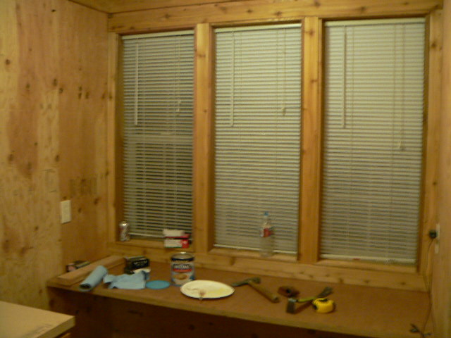

Ok, did the formica counter tops and dining counter top. Formica came is 4X8 sheets (this size can vary from 3X8, 4X8. I used 2 sheets, total cost was $150. Did it myself, but did have a pro explain it to me before I tackled it, plus lots of research online. I built the counter myself (wood part) plus the formica work. For those who think this is real hard, its not. It was a snap and an absolute blast. Anyway, photos above are flake (sawdust looking stuff, i ts the flattest stuff around and very critical, imperfections, bumps etc shows up real well with a shiny surface) board set but not covered yet, now they are covered. I'm winding down on this project. Now that I'm getting the hang of building, I'm almost done. I'm chomping at the bit to start another project, ie my final home. But I have about 5-7 before I need to start that project.
The 3 stools are the "saddleman" type and they are also in a stressed finished. They are new, but look 100 yrs old. Solid oak too.
