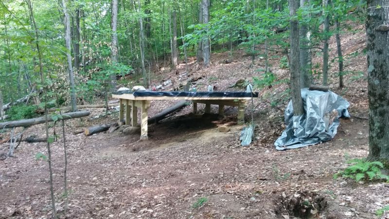

As i watch endless youtube videos as i dream about building a cabin, i came across this one.
The guy,
OFF GRID HOMESTEADING With The Boss Of The Swamp, swears by this stuff as an excellent insulator and something the rodents want nothing to do with. In one of his videos, he claims to buy a roadside shabin, laid down a layer of this on TOP of the subfloor, and then laid down another plywood layer (didn't specify thickness of 2nd layer). He claimed he went from the cabin always being hot up at head level but cold at foot level, to a consistent temp from floor to ceiling.
Foil Bubble Insulation
This caught my attention because i've been thinking through the elevated platform i would need to construct for my cabin as discussed here.
The stuff on HD's site claims R value of 3.7-21. So I scanned through the installation guide to see how that was possible with something so thin. I primarily looked for examples related to an elevated platform. Page 14 shows a crawl space install where they attach it to the bottom of the joist and they claim a R16. However, the image might be misleading as i assume when they saw crawl space it means all 4 sides fully enclosed. Page 15 shows the same as 14 but with a second layer hanging between the joist and this gets you up to R21.
Wondering what sort of R value i could expect on a elevated platform build?
Anyone have specific experience (good or bad) with this stuff?

I installed it under my floor sheathing. Im not done my build yet so cant offer any opinion on results. I figured it wouldnt hurt in keeping varmints out. I also probably wont be spending too much time in the Winter up there.

lburners is your floor elevated? So you pinched this stuff between your sheathing and the joist...did you do any additional insulation below that?

Yeah Will1e my floor is elevated. Its pinched in there. No additional insulation yet. Like I said I dont think I will be up there much in the winter and a woodstove in a 12x 16 should get plenty warm. Im thinking much in the same way as Brett that its basically a vapor barrier. It was easy enough to roll out when putting on the sheathing. Its like a placebo it made me feel warmer just putting it on there.

I installed it as he did. My cabin is open-aired underneath as well. I wanted it because I didn't want moisture or mice underneath.
As previously stated, it's good as a moisture barrier and does provide *some* insulation. The guy in the videos also has skirting that he lined with it as well - that's what really makes the difference, and I believe he says so. I think he's being completely honest and isn't manipulating anything at all.
