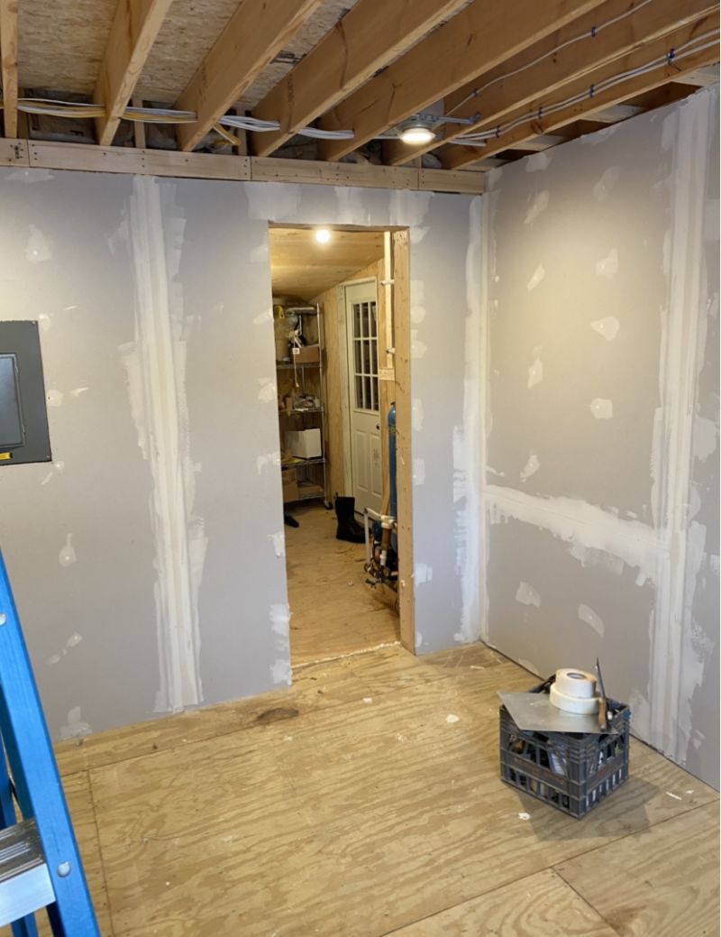

# Posted: 29 Jan 2021 06:34pm

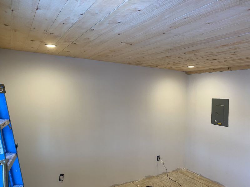

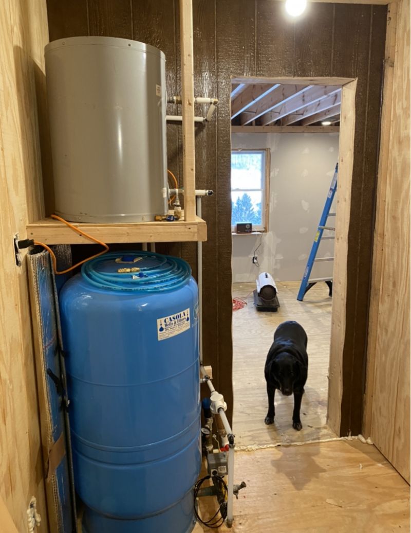

Well just wrapped up the second coat. While waiting for it to set up I moved my well tank a d water heater into the new utility room and started on the bedroom ceiling.
Irrigation Guy
# Posted: 29 Jan 2021 06:37pm

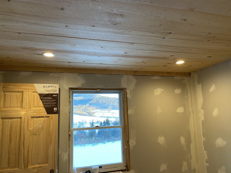

A few more

# Posted: 30 Jan 2021 05:10am
Looking good. What's the plan to hide the 2x4 ledger under the joists?
Generally you dont want end butt joints li in the wall like that. They are very very hard to not see after you paint.
Irrigation Guy
# Posted: 30 Jan 2021 07:11am
Quoting: Brettny
Thanks, I plan to tack a piece of 1x4 rough sawn over it on both sides then pack out the other two walls 3/4” and do the same so it has the same gap all the way around the room.
This was my first drywall project and mistakes were made, hopefully won’t be too noticeable once it’s painted
# Posted: 30 Jan 2021 08:06am
Check it for shadows with a light along the wall before you paint.

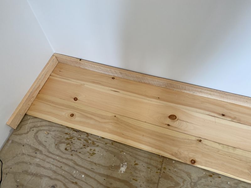

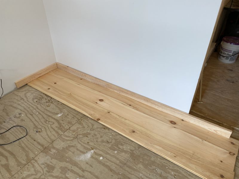

Thanks for everyone’s help, it was a learning experience, I am glad I didn’t start in the main room with higher walls and lots of corners. I got a lot done the past few days. Now I need to think about the floor I did a little mock up of an idea, what are your thoughts on t&g pine as flooring sealed with tung oil?
# Posted: 31 Jan 2021 06:56pm - Edited by: gcrank1
Tung Oil was nice but mighty expensive compared to BLO (boiled linseed oil) last time I used it (decades ago) and not what I'd call a floor finish.
Irrigation Guy
# Posted: 31 Jan 2021 07:27pm
I did tung oil on my wood counter with good results and when I compare the live of the pine to engineered products I am leaning towards the pine
# Posted: 1 Feb 2021 08:42am
I have 2 large dogs and now a baby. I put unfinished oak flooring in 7-8yrs ago and finished it with 2-3 coats of tung oil. Let me tell you it wears very very well. You cant see a scratch on my floor. It is different than many other finishes as it soaks into the wood. I haven't used boiled linseed oil on any thing.
Get the real tung oil, not sold at big box stores.
Please please dont use polyurethane.
# Posted: 1 Feb 2021 01:09pm
BLO is an oil finish, as is Tung Oil, both have that advantage of soaking in and easy spot repair with very good blend in.
The more hardeners the more the finish moves to a varnish with a hard shell top surface that resists damage but when it happens it is thru the finish and spot repair is not easy.
Big + to oil finishes.
Teak Oil, like used for fancy wooden boats might be another option in oil?
