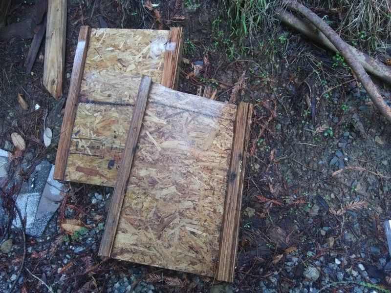

How about blocking between the I-joist anywhere else in the rafters or floor? I've seen some guys cut a piece of I-joist 1.5" narrower than the space between 2 I-joist, then nail scrap 3/4" plywood to either end. That gives them a big nailing flange then. Here's a picture of it.
