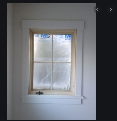

I have a bunch of baseboard out of a friends remodel I'd love to use up for my window trim, but now I'm thinking it wouldn't look good, plus all the corners would have to be 45* cuts, right? Thinking something like this, with the top board long and a shelf incorporated at the bottom is more cabin decor.
Let's see what you've done.

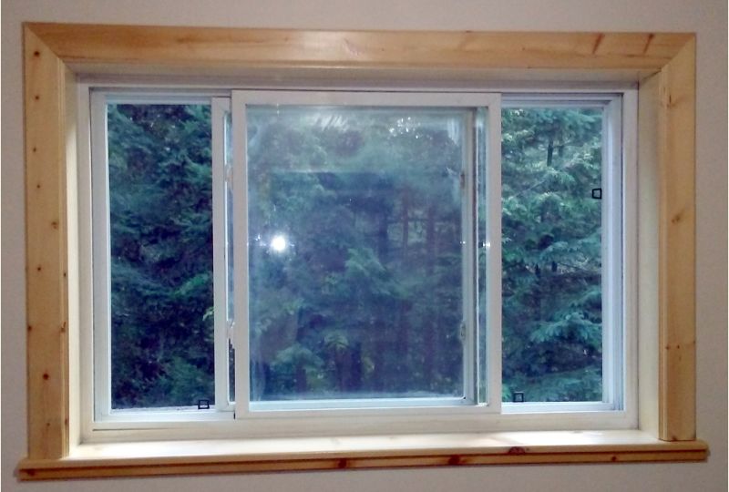

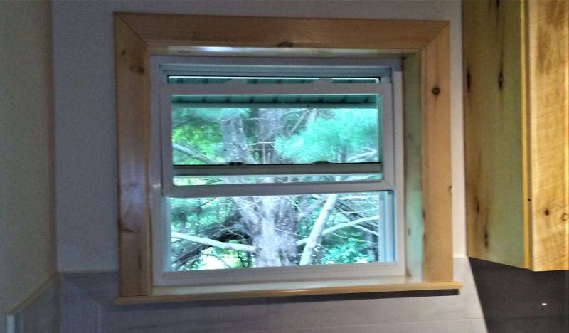

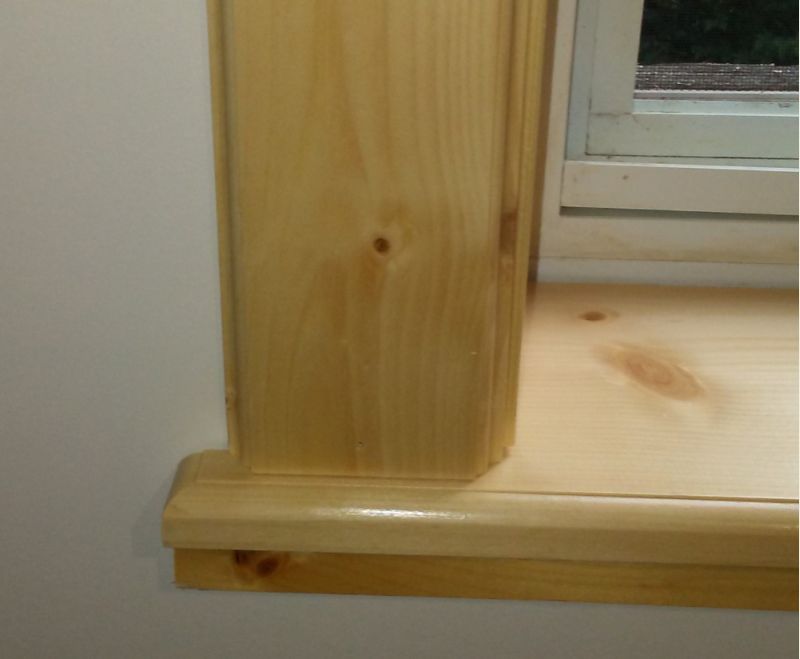

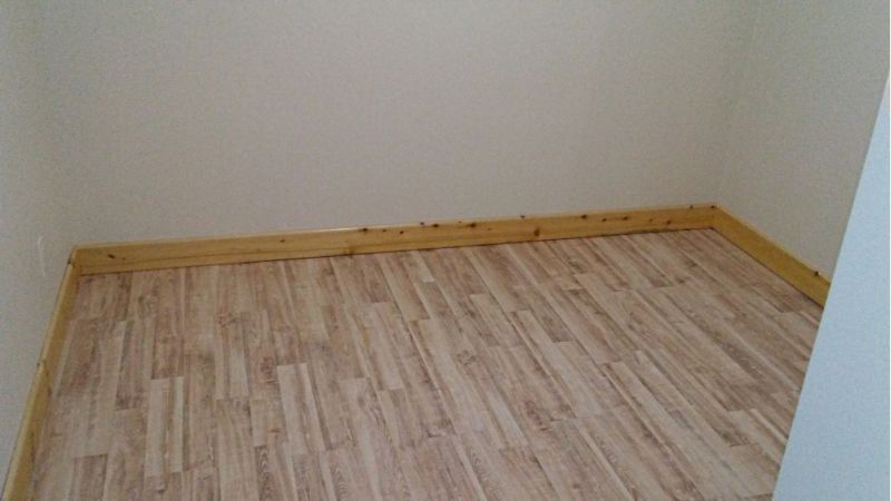

I made all my Casings, Baseboards & Trim out of knotty pine, using left over T&G I had from the ceilings.
Casings are 3-1/2" wide and I used a Roman Ogee bit on the router to make the edges.
Window Sills are 6-1/2" deep, milled with a simple Round bit but set "in" so there is a slight lip to add detail.
Baseboards are 5-1/2" and also trimmed with a 1/2 round bit where I trimmed of the Tongue.
All have 3 coats of WaterBased Polyurethane.

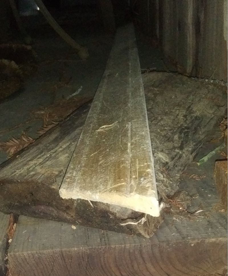

Like the furring strips idea. Also reminds me I have a stack of old redwood fence boards I could run through the planer.
