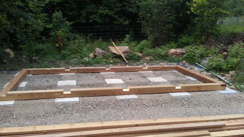

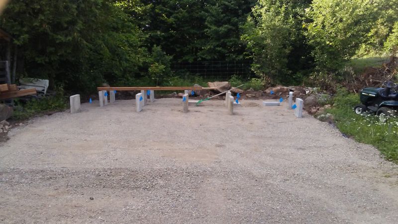

Attached photo's are for my Toolshed Base 16'x8' with 6x6 PT on 18"x18:x3" "Cottage Blocks". Gravel used for this was roughly 12 Metric Tons of Grade-A Fine Crush which is very packable with a compactor.
gravel base packed GeoCloth under.
Blocks, placed, Links Filled & Packed.
6x6 ready for EndCut treament prior to final.
