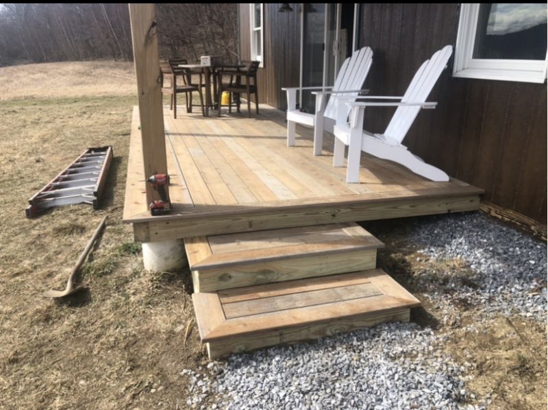

# Posted: 24 Feb 2021 07:44am
Irrigation guy your porch is #2? It looks prety darn clear to me.
For me our porch is going to be covered so il use PT. Rain and sun are the two major things that destroy decking. Not much of an issue with a roof over it. Depending on PT prices at time of the build I may just saw my own pine boards for it and stain them.

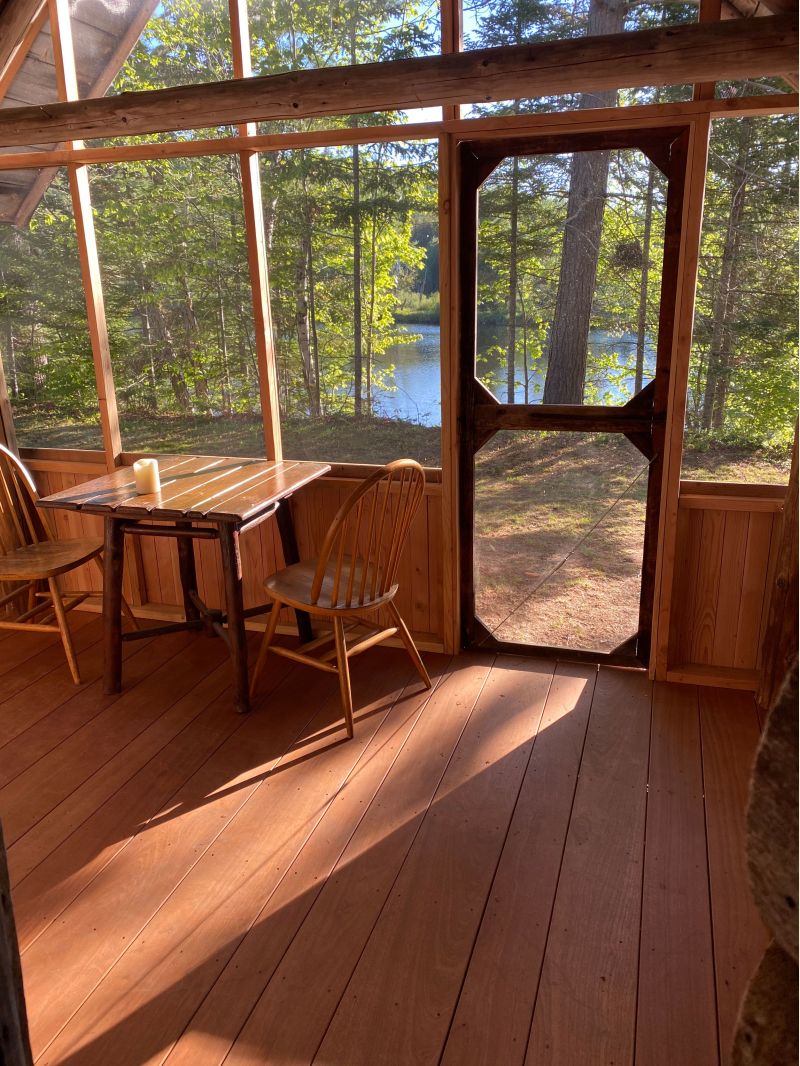

# Posted: 19 Aug 2021 11:09am
Hello
I ended up using 5/4 Sapele for the floor with 12" on center joists. Thanks for your help and advice!

# Posted: 19 Aug 2021 06:01pm - Edited by: Irrigation Guy
Looks good! I like the random widths
Riv
# Posted: 20 Aug 2021 10:02am
Thanks Irrigation Guy! I was nervous about using random widths but now I love it! Cheers!
Curly
# Posted: 20 Aug 2021 10:25pm
I like the floor, the porch and the view! Very nice!
