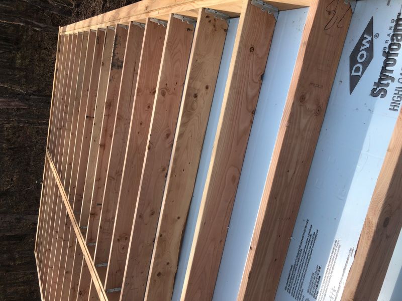

My cabin I used 2x8's, they span a little over 7'. No spring.
Joists and Foam.
Joists and Foam.
