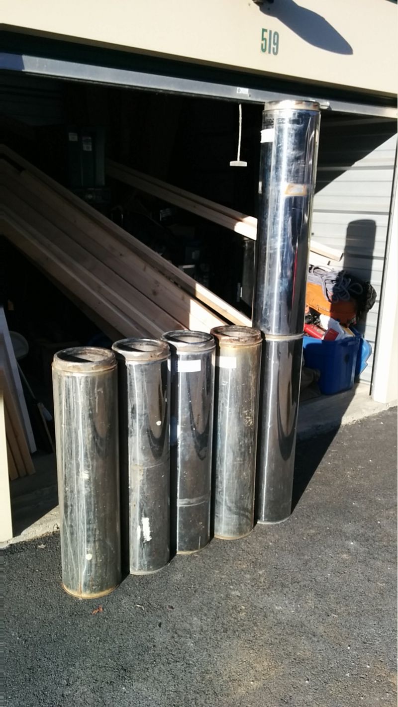

Did a little web search with mixed opinions. I can get some free 8" insulated pipe and I have a stove with a 6" flue. Would be very pleased to not buy a bunch of 6" insulated pipe. Thinking I would go 8ft or so uninsulated 6" pip adapted to the 8" insulated which go another 8'.

Well I grabbed for at the very least to make a couple bucks. This might be my chance to post in that deals thread.
