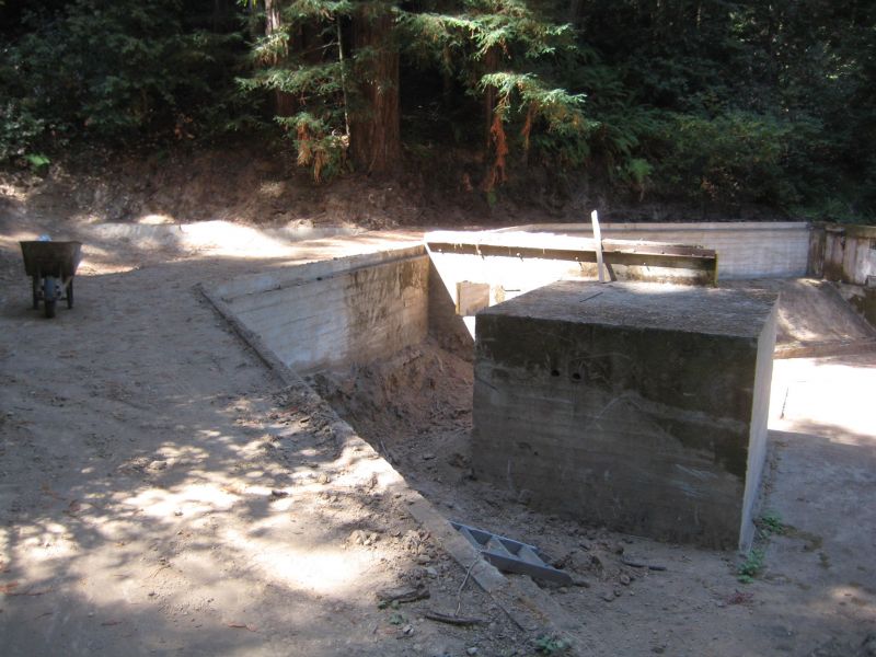

Well there's concrete..
I have a concrete box 14x14. Was a bomb shelter. 8" thick walls. You're welcome to, you haul.
