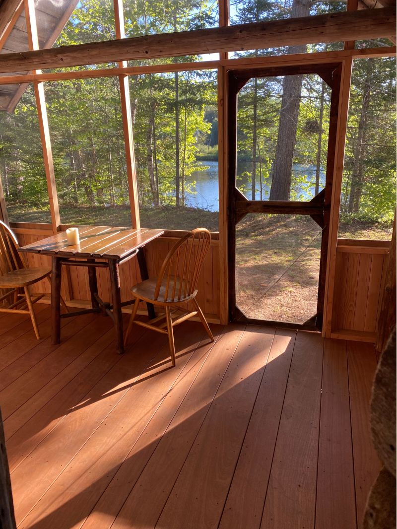

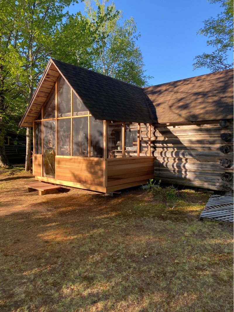

Hello Everyone!
I finally finished rebuilding my covered porch! Thank you to all who provided advice!!
Riv
# Posted: 19 Aug 2021 11:00am
Hello Everyone!
I finally finished rebuilding my covered porch! Thank you to all who provided advice!! 1.jpg

# Posted: 19 Aug 2021 11:04am
Looks great! Love the random width decking!

# Posted: 19 Aug 2021 07:56pm
Very nice!

# Posted: 21 Aug 2021 11:26am
really lovely
# Posted: 21 Aug 2021 11:43am
What a perfect place for your morning coffee!

# Posted: 23 Aug 2021 03:09pm
Wow. That’s a beauty!
