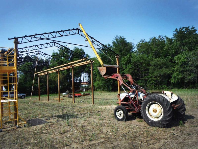

If the bucket on the tractor can safely lift a load of dirt/gravel, it can surely safely lift a house log. I've used a small Kabota tractor to lift 8" three sided logs up to 25' in length with no issues. And have used a 10' gin pole chained with chain binders in that same bucket to extend the lift to place higher logs using a nylon strap.
.... A nylon tree protection strap or lifting strap on the balance point won't mar your logs. Just be sure to place a block under the log as you set it down so you can remove the strap.
On our full sized backhoe at the city I worked for, we torched holes in the bucket to allow bolting the forks.... we used worn out road grade blades.... to the bucket. 2 x 3/4" grade 8 bolts per fork. No shifting or coming loose.
Safety is very important and I am not down playing the need for caution but tractors/backhoes with front end loaders can do a great deal of work besides just moving dirt and rock. The counter balance is already factored in.... unless you are using a farm tractor not really designed as a loader with a universal front loader attachment. Wheel weights may be needed on a make shift rig but you still have the considerable weight of the tractor as counter balance.
