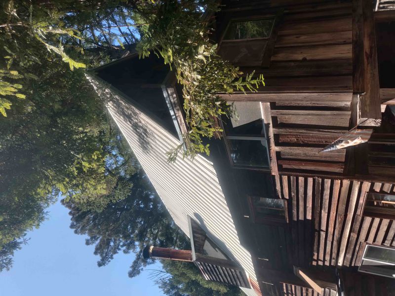

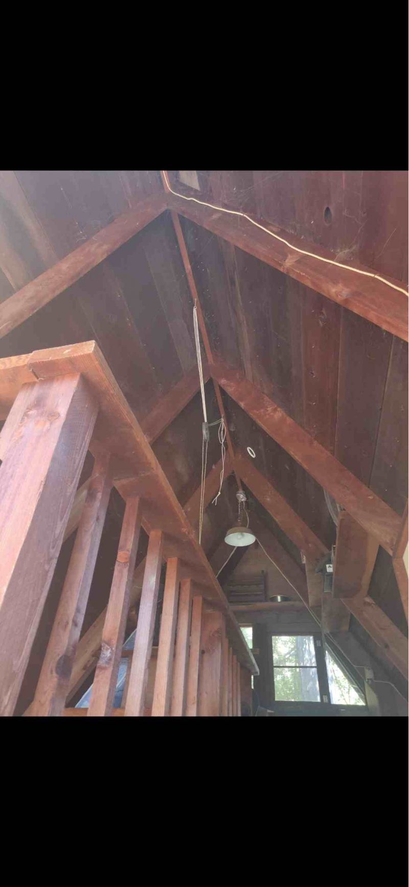

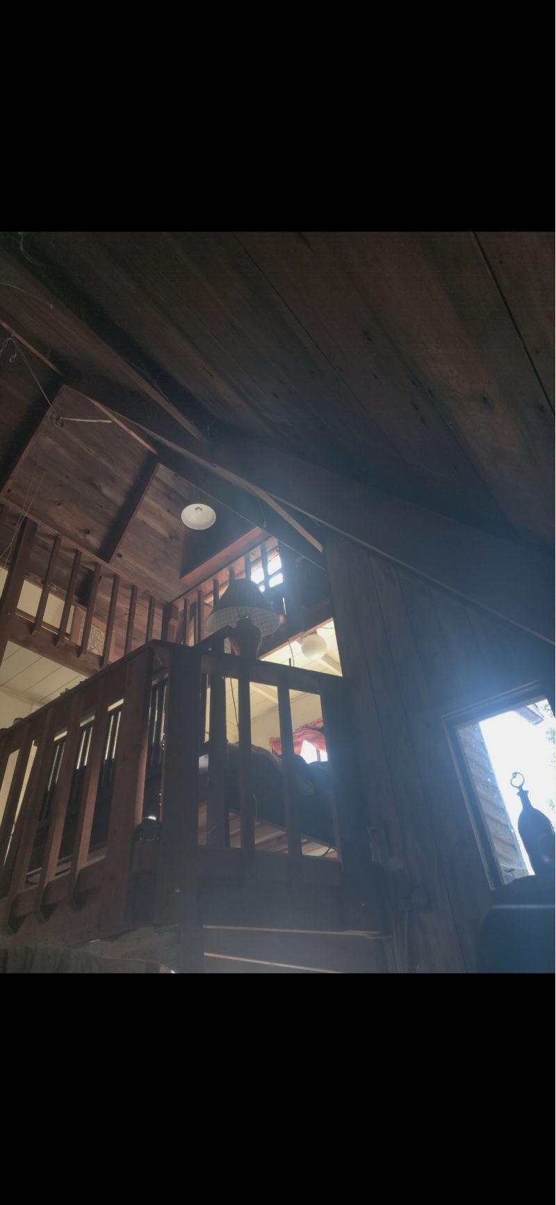

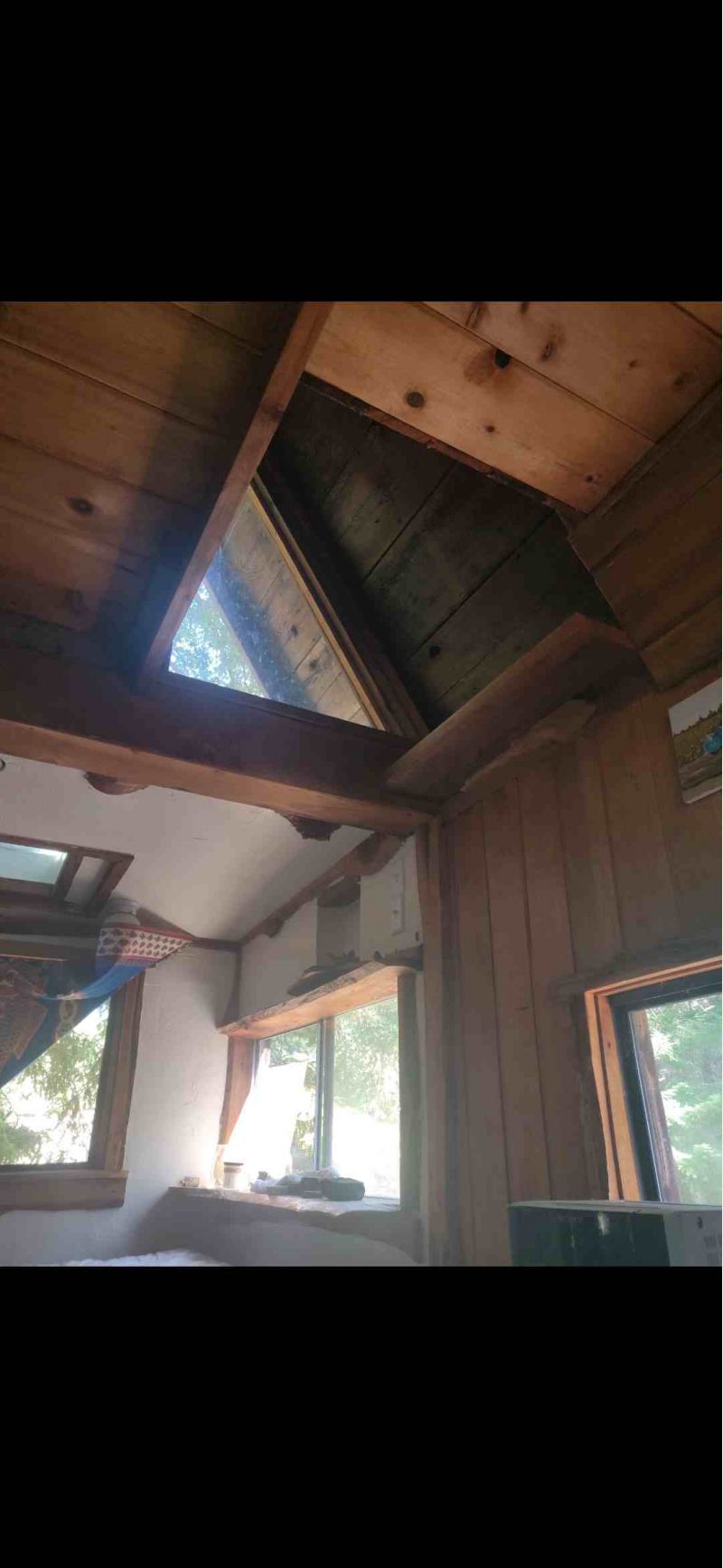

Hey all, I am here for advice on a cabin I am renting out, with a stickler of a landlord who doesn't want to insulate the cabin (some walls are insulated); however, he has offered to buy a new woodstove...
My problem is the roof; it is of the metal variety, is uninsulated, open-beam, and not vented. The interior of the house is 2 story with open floor plan all the way to the attic, which is basically the 3rd story. Its one big open space...
It's like an oven in the summer (weather reaches 100°) as the cabin is in the sun with southeast exposure. In winter, the heat from the woodstove goes up and doesn't stop. My question is what can I do to lower temps? I will include pictures soon.

Ceiling Attic
Ceiling Attic
Ceiling 1
Ceiling 1
Ceiling Bedroom
Ceiling Bedroom
Southeast Roof
Southeast Roof

gcrank's idea is probably the best option. Not sure if your on grid, but if so some type of portable ceiling fan would help a lot for winter to keep some hot air moving lower and for a breeze to help cool in the summer, but that can only do so much.

I totally agree on a fan to move the heating season warm air stacking in the top down into the living space. And in the hot summer you need to get that hot air out, open a high window and put in a box fan?
At our one story place Im setting up a small bit of high ductwork to fan force the hot summer air out what was the gable end woodstove pipe hole. With the lower windows open it will draw through and at least it will be air moving past the skin for a cooling feel/effect rather than still, hot air.

Imo you wont be able to stop all the heat gain but anything to stop solar gain though south windows would be good. Id open lots of the others to just let the air flow, especially at the top where it starts to stack 'down', you already know you cant control the inside temps. Open widows low down on the cooler shaded side(s) to let that pull in when the top hot air moves out.
# Posted: 10 Apr 2021 09:05pm
Blackout shades in sunny windows.
