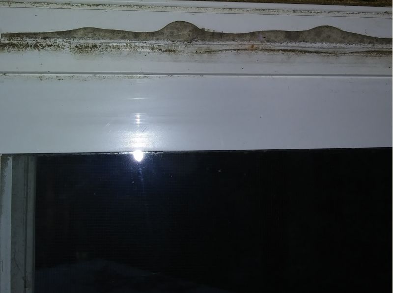

I need to get this caulking off the used windows in my cabin. Hard as a rock, razor blade won't even scrape it off. I tried goo gone, no help. Brake Clean softens it but also the vinyl. Home Depot has Krud Kuttter caulk remover. Anyone use it?

No, but I've used heat, both a torch and an electric heat gun. But one has to be careful not to heat crack the glass.
Here in NM in the 60's a lot of homes were built using an iron window frame with many single panes of glass per window; glass panes held in place with putty. When replacing the old windows with newer more efficient ones we would soften the putty or caulk with heat the remove the glass before working on removing the metal frames.

Yes, don't waste your money. Get a heat gun instead.

Thanks guys. I brought a heat gun up to the cabin, just been bogged down with the paneling project.
Those vibrating multi tools... I bought one, still in the box. Haven't ever figured out what it does better than other tools. The caulking on these windows is on the vinyl, don't think it would work there?

Wonder if you could rig up a jig that rides the smooth vinyl frame and/or glass for one of those mini tools to act like a surface cutting 'router' to just knock off the terrible high spots and ugly.

https://googone.com/caulk-remover
Cover with clear kitchen food wrap, let sit for about 8 hours.

Got the last of my windows cleaned this morning. So the drill is heat gun, which softens the large strips and gets it off in long chunks. Then the gel remover softens the remaining thin film to allow easy scraping with a blade. Tedious, boring, thankless work. My specialty.
