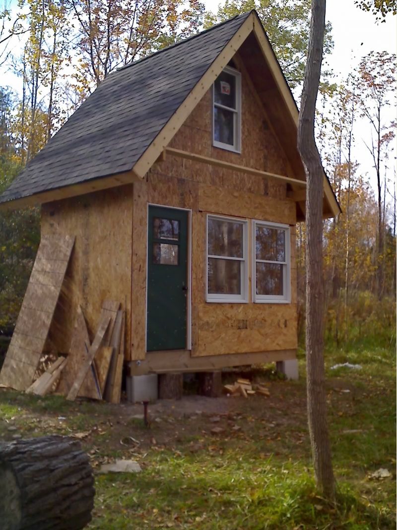

# Posted: 4 May 2011 07:13pm
If I am doing this correctly, there should be a picture of the shed
Its floor is 8'x12'
Yes, using the spray foam is a little worrying because of how permanent it is. Your experience with moisture on the ceiling is also worrying.

shedb
shedb

# Posted: 5 May 2011 07:56am
looking good!
After I tore the vapour barrier down from the rafters in the loft, the loft was fine and the wood rafters dried immediately...wasn't a big deal.
After more research...the rafter size is not the issue....I made the bunkie too air tight.
This is why I'm leaving breathing space around the foam insulation in the loft rafters and will not be putting vapour barrier back.
I'm also putting a small vent in the wall at the peak.
I use the bunkie up until late fall and then go up around this time of year. Summer is great, as lake huron is at the end of the road...five minute walk. Lake access...but not the taxes!!!
Probably will never use for middle of winter to stay over...get;s too small with two boys, a dog and all the winter clothes...tried it...wasn't fun.
Long term goal is to build a 1000 sq. ft. cabin (minimum allowed)...700 ft footprint / 300 ft loft...passive solar with a woodburning stove. Stay off the grid and away from the ridiculous hydro bills...if possible!
Your place will look great with cedar siding!
