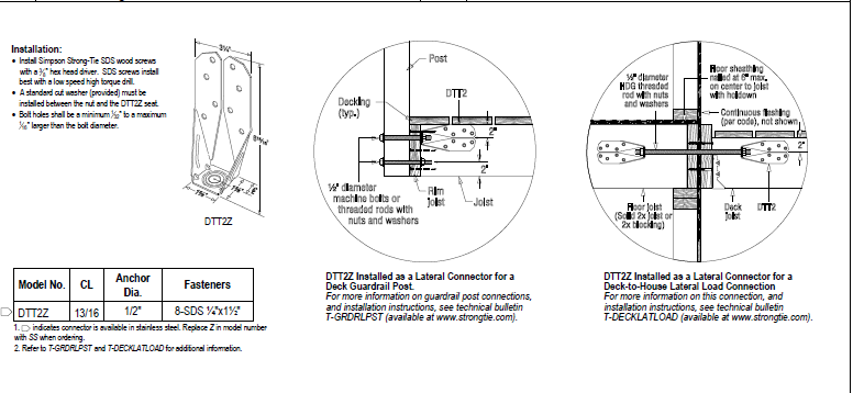

# Posted: 4 Apr 2021 08:31pm
It is a code its trying to meet.
The DTT2 can be used to satisfy the IRC provision for a 1,500 lb. lateral load connection at two locations per deck. Additionally, the DTT2 has been tested and evaluated in deck guardrail post applications to resist the code-specified lateral forces at the top of railing assemblies. The DTT2 is also available with longer 2 1/2" Strong-Drive SDS Heavy-Duty Connector screws (model DTT2Z-SDS2.5) to achieve higher loads when needed. The DTT2 fastens easily to the wide face of a single or double 2x using Strong-Drive SDS Heavy-Duty Connector screws (included) and accepts a 1/2"-diameter bolt or anchor bolt.
# Posted: 4 Apr 2021 09:07pm - Edited by: ICC
Quoting: socceronly Do you want, in principle the bolt to pull the joist in?
Not pull, but hold in place with no movement. Maybe just semantics but to me "pull" means to move something and hold means to, well, keep from moving.
The DTT2's are heavier gauge steel(14 ga I think) than most of the common Simpson brackets. The way they are bent and folded makes them able to resist more force than most 90 degree bent angle brackets, like the A66 even though the A66 is 12 gauge.
So yes, you could improvise and maybe come up with a solution that is as strong, but it would not meet code. I don't push code just because it is code, but I know that when it comes to something like securing a post for a deck guardrail or securing the lateral load for attaching a deck joist to the building, these DTT2 are engineered to do the job and one can find the tested load specs in the Simpson catalog. They make for a strong and safe deck-to-house connection when a DTT2 can be used both under the house floor and the deck with a threaded rod through the ledger connecting one DTT2 to the other. That is where most deck failures occur.

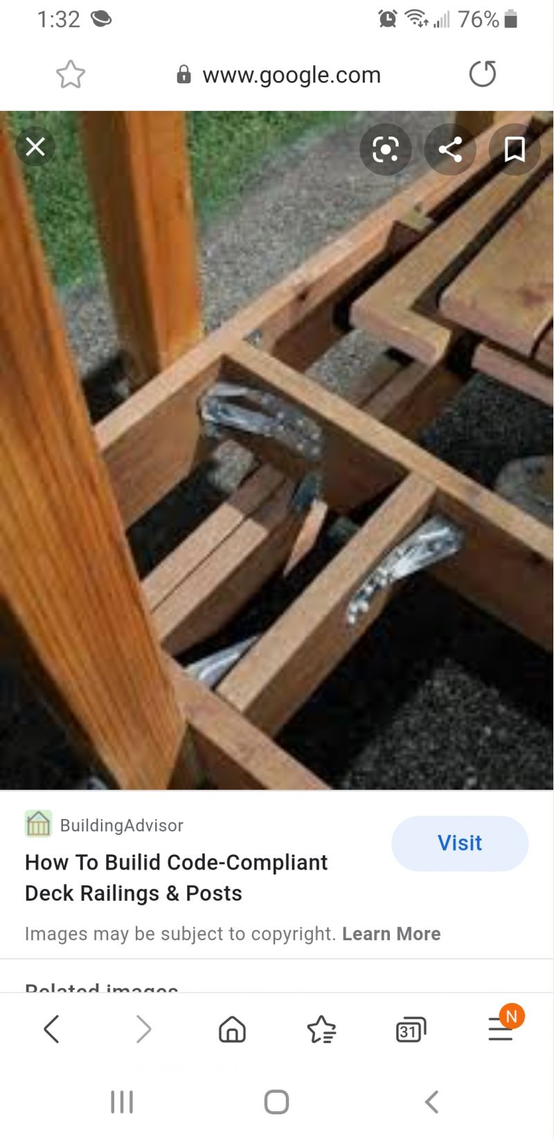

# Posted: 5 Apr 2021 06:44am
Are we talking about this one?
If so $18 for two is hardly gold. Look up the price for a 6x6 post base. They cost about $22 each here and dont come with the bolt.
Ask your inspector but you may not pass inspection if you make your own metal connectors. If no inspection needed I would just buy a small piece of 3x2x1/4in angle and make them.
# Posted: 5 Apr 2021 06:53am
Also there is a way to get the same tension on a rod connected to your joists with no hanger, only blocking. This simpson bracket wouldnt be my first choice for a deck railing it really only looks like it would hold the post in one direction.
# Posted: 5 Apr 2021 09:22am - Edited by: ICC
Quoting: Brettny Are we talking about this one?
That is the one. They can be used as a hold down as pictured as well as a tension tie to secure a deck to a bldg. or secure a guardrail post to a deck structure.

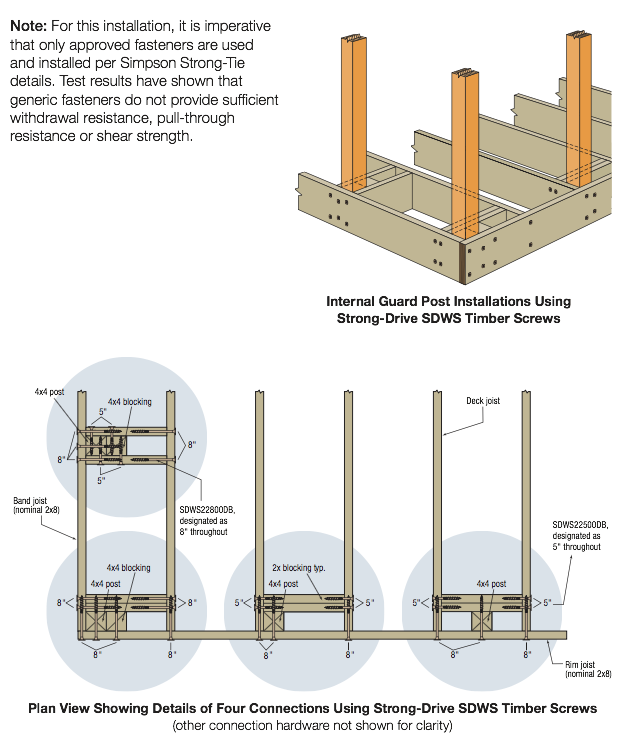

# Posted: 5 Apr 2021 01:29pm
Since they cant be found have you thought about useing blocking? You can even have the same tension threaded rod with no metal connector and use blocking.
# Posted: 5 Apr 2021 01:34pm
The pic with the metal connector theres really nothing keeping you from running that threaded rod all the way though the next joist or adding more blocking parallel to the floor joists and useing a longer threaded rod. tI3B7.png
