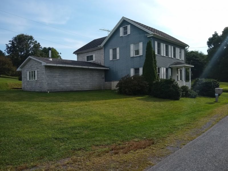

I'll track down a picture of the house and post it...Just wondering if anyone has dealt with a situation like this and could offer some advice....
jsahara24
# Posted: 7 Apr 2021 01:49pm - Edited by: jsahara24
Couple pictures I found......i'm at work now, the roofer is going to wrap up the main house roof while we figure out the best way to handle the addition....Thanks

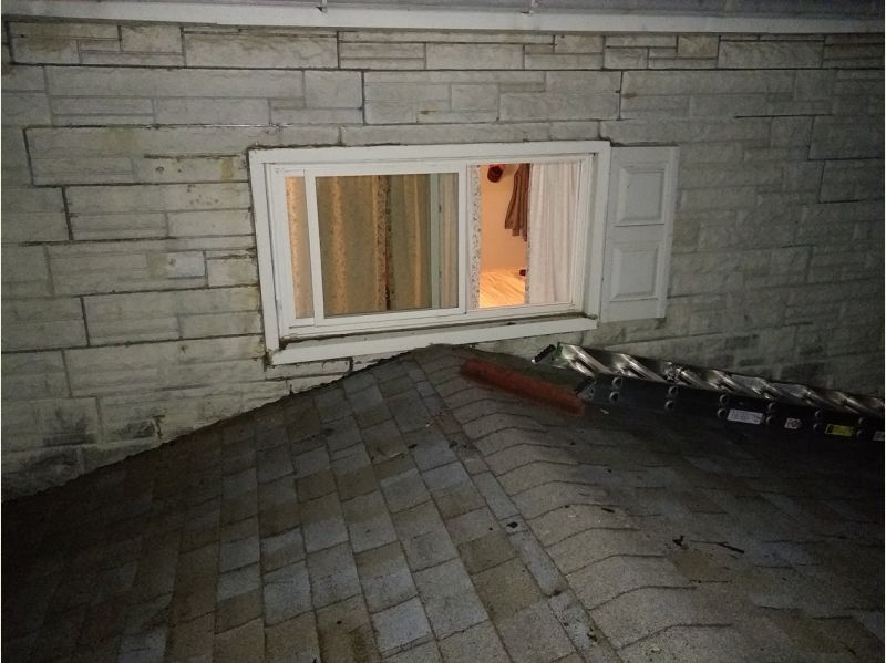

The ridge is right at the bottom of the window....pic attached....

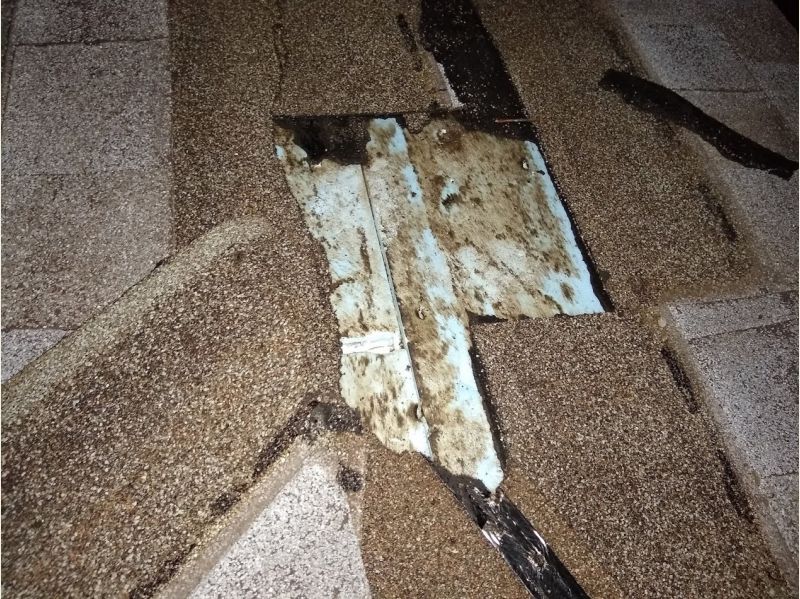

I got home from work and checked everything out. The foam board depth is to my first knuckle, so 1" appears correct. On top of the foam board is tarpaper and then shingles. The foam board (where we opened the roof up anyway) has mold growing. Pic attached.
I am going to go read that PDF, thank you for the advice. Seems like that window isn't going to be able to stay there with either venting the roof or providing the necessary foam insulation to avoid venting.
Only good news is that the wall with the window is wood framed. So I'm thinking adding two windows on either side and removing the one in the middle seems like the direction I need to go.

That window is alreaty way to close to the top of the roof to properly flash it. It does look like it's on a load supporting wall so moving it up 16+in may be an issue.

I think most of your issues are from having shingles nailed to foam board. I'm pretty sure none of the manufacturers would say that's acceptable.

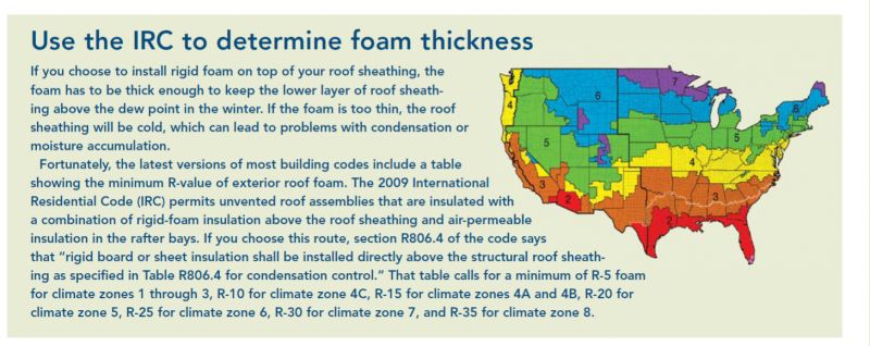

Based on the PDF I need R20 to keep the heat transfer from occurring and eliminating the condensation issue...The existing foam board doesn't have any of the joints taped or anything, so I'm sure that isn't helping either....

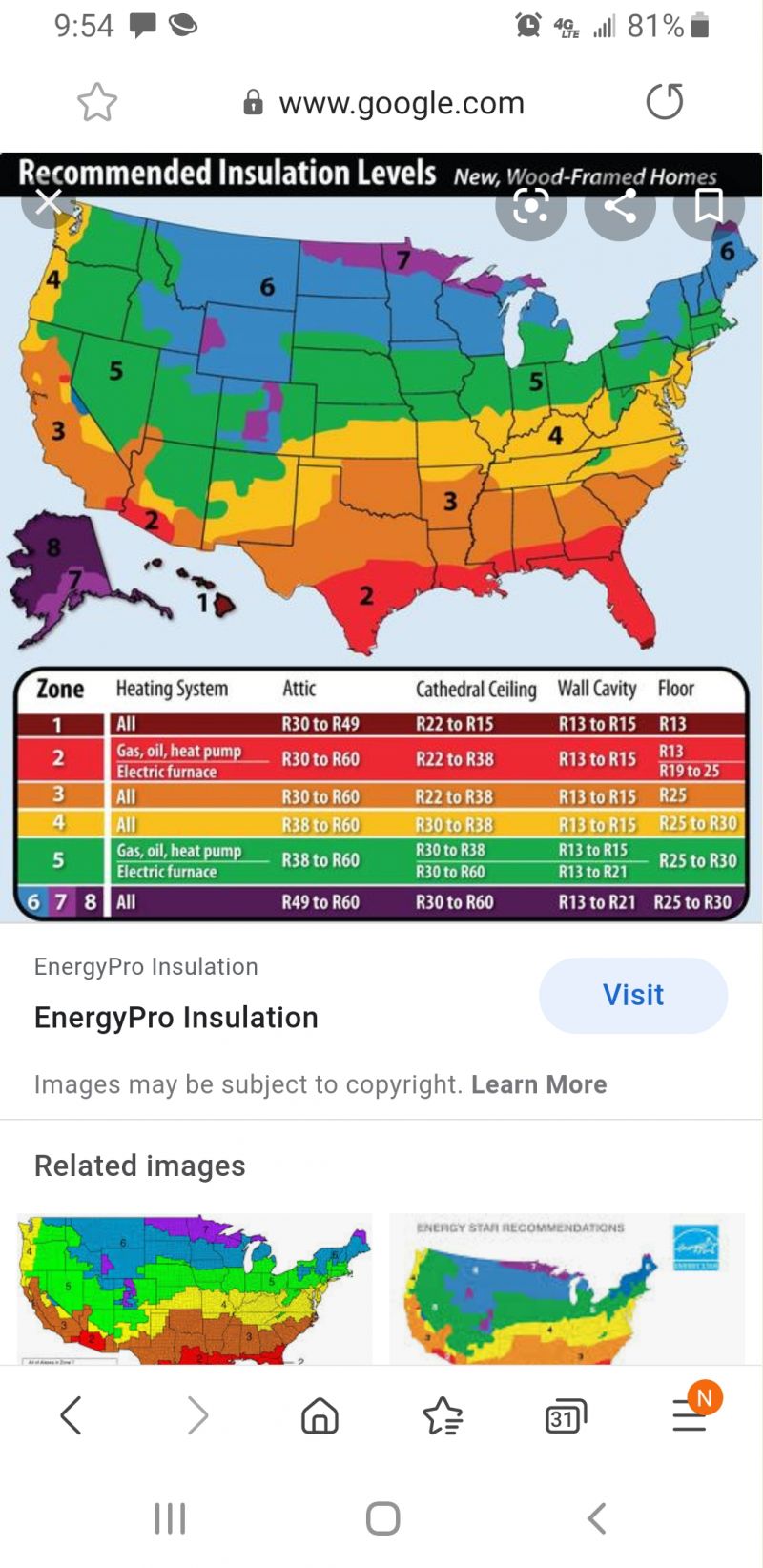

Zone 5 would be r30 minimum.

The image below is from the PDF above. That says R20 will stop the condensation issue, but maybe I'm missing something.....Did the code change over the last 10 years? Or is R20 what's necessary to stop condensation, but more is recommended?

Yes, virtually anything you do will be an improvement. You may want to see about a ventilation system that can move air from that room into the rest of the house through ductwork if at all possible.
Quoting: jsahara24
R20 satisfies the science of dew point temperatures and condensation. For energy saving more is listed as required. Mostly because most people burn fossil fuel nat gas or oil. Wood is renewable but still has to be burned. There are different views on that.
