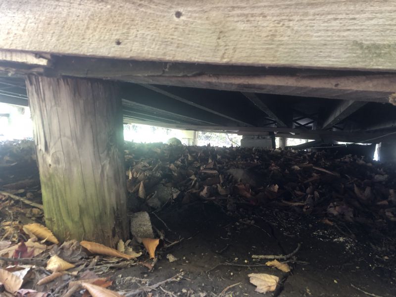

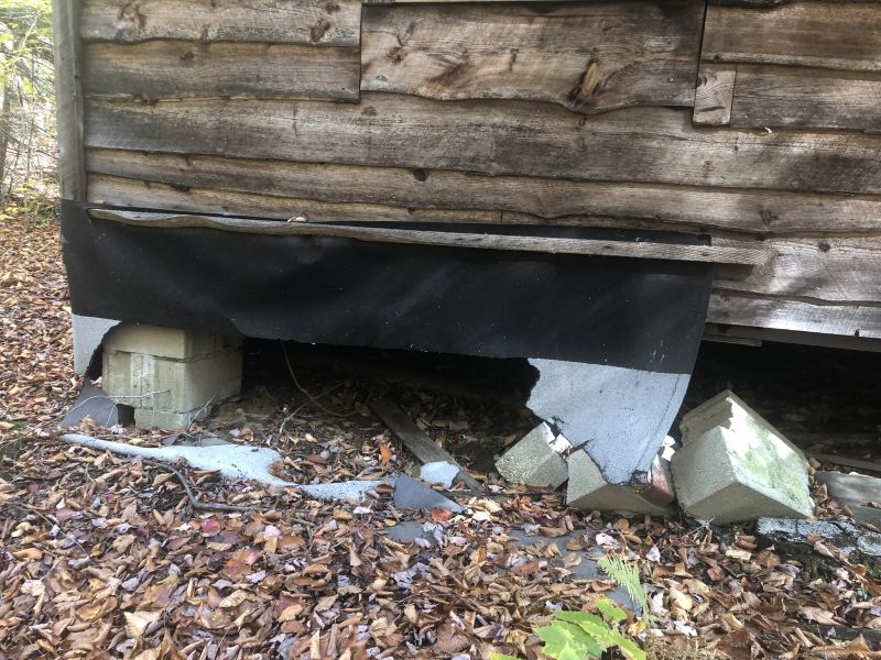

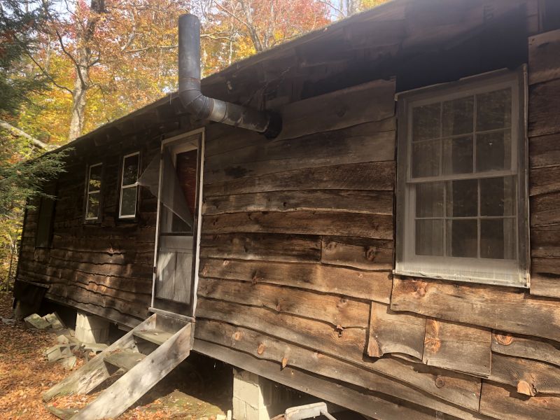

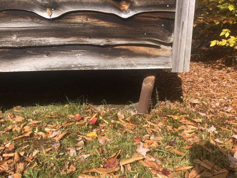

I'm considering buying an off-grid cabin in Western MA, however the "foundation" needs a lot of work. I believe the cabin was originally built in the late 60s early 70s and has been used seasonally by the same family since then. Any advice as to how to go about fixing the foundation in a relatively low cost fashion would be greatly appreciated. Feel free to be as brutally honest as you would like - if you think the project would be exorbitantly expensive and or time consuming please let me know. This cabin would continue to be seasonal but I do of course want it to be safe.
See photos attached.
As far as I can tell the cabin is sitting on at least 3 different types of material - wood posts, metal posts, and cement blocks. There do not seem to be any concrete pads underneath any of this. As I mentioned, the cabin has been standing for at least 50 years and the previous owners have clearly done some work on the foundation over the years, replacing some of the posts with newer cement blocks, however this seems to be a temporary fix. Having said that, I am ok with a "temporary fix" as long as the building is safe to inhabit. The cabin has been standing on its current foundation for many decades so clearly something is working despite it's rudimentary nature. I'm not looking to over engineer, and ideally would like to do as much of the work myself with the help of a friend who has a good amount of experience with building small structures.
The cabin is accessible by a road so getting supplies in should not be an issue. I'm not sure of the exact dimensions, but it's probably 30' x 30' with about 2 feet of space underneath the cabin.
Any help / advice would be greatly appreciated! Thanks in advance and feel free to ask any questions.

How much below value are you going to pay and how much are you thinking about spending on fixing the foundation?
From the pics shown theres more issues than the foundation. With only 2ft of working room and needing to dig down at least 4ft it's not looking good. Can you tell us about beam size and spacing?

Posts that are already rotated out of plumb are not a good sign.
Two feet of clearance under a building is hard enough to negotiate even without thinking of actually doing any work under there.
Can your "friend who has a good amount of experience with building small structures" have a look at it. I assume he knows more than you about this sort of thing. But I could be wrong; depends on what you mean by small structures. A habitable cabin is not quite the same as a storage shed.
From those 4 pictures, it does not appear to be ready to fall over, but pictures can not always convey the reality. But the amount of work necessary and the degree of difficulty may not be worth it in the end.

Some times starting with nothing is alot easier. Repairing a foundation is always easier when the house isnt on it. I have repaired a 40ft section of my houses foundation..its no fun. It's far easier to do correctly the first time.
Other issues I see are the chimney black pipe outside of the cabin and the cobbled up live edge siding below the window. Both things that tell me pride in the final product was not a thing for who ever built this cabin.

# Posted: 16 Apr 2021 09:00am
How many support beams and associated piers are supporting the building now? The perimeter piers could be addressed with a reasonable amount of effort, but those underneath in a 2-ft clearance would be a serious challenge. Cutting open the floor and working from inside the structure may be required. Make sure things are properly shored up before venturing underneath. You don't want to end up like that wicked witch of the west (or was it east...).

Don't let all this scare you off. If you love the place, it's a good price for you, and you're handy, give it serious consideration. Looks to me like you can just fix up the block foundation. Jack the cabin up by each pier just enough to allow you to disassemble and reassemble the pier, but with better blocks, gravel base, and drainage. Maybe you have to add some piers, too, maybe not. It looks to me like you have enough room the wiggle around under there to get it done. Is it the best or "right" way to do it? No. But, if done right, it's your low-cost "temporary" fix that will last a long time.

I look at the place and it's a nice-looking rustic cabin, without having seen the inside. If you're heart's in it, and your pocketbook can support it, don't let this deter you. If you're paying for just the land essentially and the cabin seems otherwise respectable, it's a steal for you.

If you haven't started yet. Looks like there are only perimeter piers, didn't see any in your pics that were set inside under the floor mid span. Those would be easy by over digging new holes and being accessible from along side the cabin.
Watch this dude's video. One by one he removed old piers and adds new. You could maybe just add new next to old.
