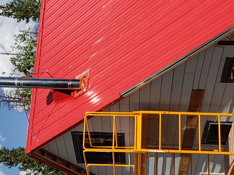

Does anyone have suggestions on the best vent pipe saver for corrugated roof with a 5/12 pitch?
This roof pictured is not mine however it is what happened to me and want to try to prevent it from happening again.
# Posted: 22 Apr 2021 08:29pm
1. Poor installation. The vent pipe should exit near the peak of the roof to allow the trusses to support the vent pipe in two places.
2. Not double wall pipe. Double wall pipe provides better exhaust flow at low burn periods and more rigidity.
3. Pipe not installed near the peak need guy wires for support.
4. No rain cap.
5. Maybe rotten roof.

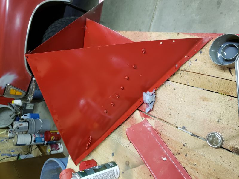

# Posted: 23 Apr 2021 02:10pm
I made my own. After looking for something that could straddle a metal roofing rib and still give me the width I needed to divert the snow properly...I found no such thing existed. I needed something that had a bit of height to it and I wanted it red to match my roof. I just used folds and metal screws to fasten the inner stiffing pieces to itself.
I get more than 20 feet at my cabin, and my stove pipe has stayed put for 4 years now.

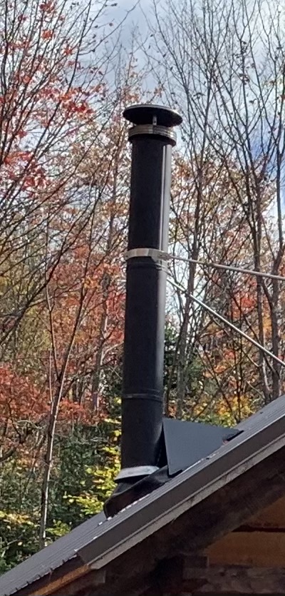

# Posted: 23 Apr 2021 04:40pm
And if you cannot make one, i use this and seems to work well
https://www.amazon.com/gp/product/B005IDHSOA/ref=ppx_yo_dt_b_search_asin_title?ie=UTF 8&psc=1
zorro
# Posted: 23 Apr 2021 04:44pm
And this is it in action/fitted
To confirm - it is the correct stove pipe - it has been painted with heat resistant matt black, from the original stainless steel
Snow Diverter
