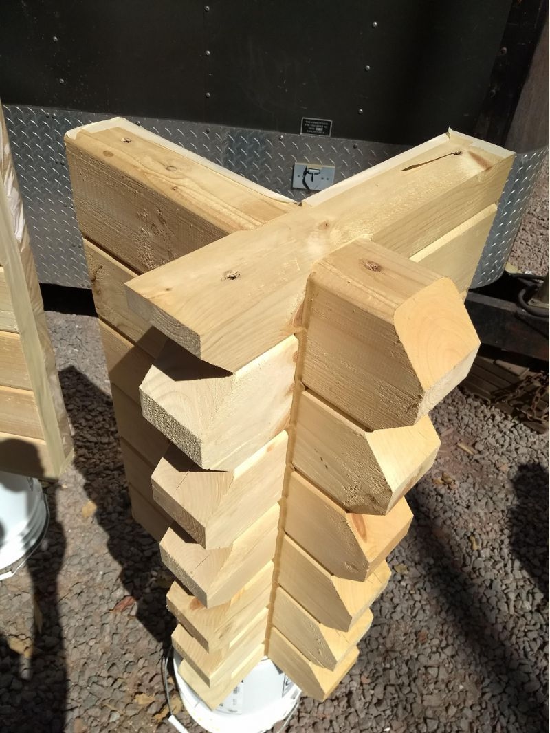

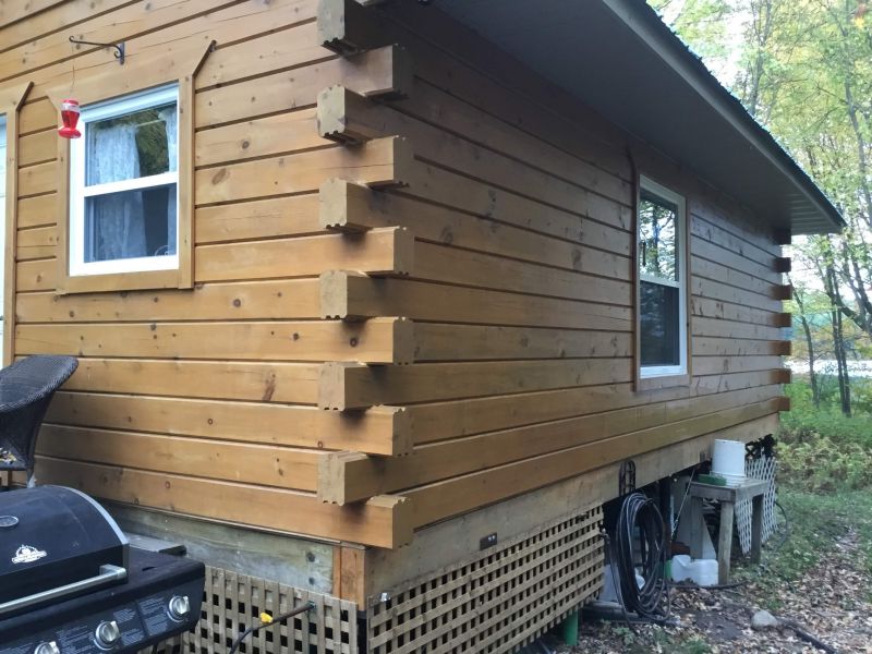

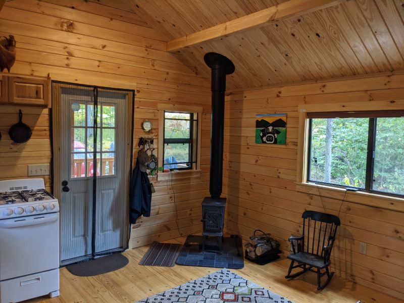

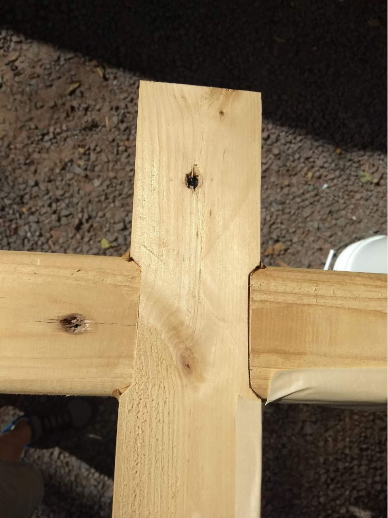

scott100
# Posted: 30 Apr 2021 11:06pm
A couple of pics attached of their corner layup method and a couple of pics of our place.

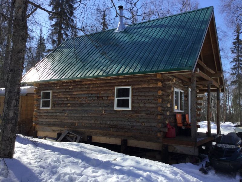

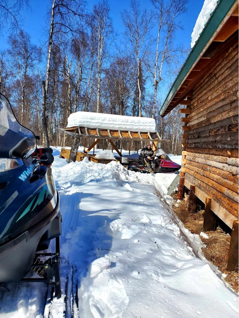

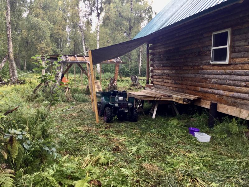

Yes I have built a log house that used a 3/4"x1-1/2" board as a guide per say. The logs also had another groove to put insulation in on each side of that. Pretty good system. That house was on block foundation.
Our 16x24, 3 sided log cabin is on a pier foundation. Actually cedar utility poles. Working great. Log structures can be heavy so I on the sides i put in 5 posts at 6' on center . The cedar poles are probably near 16" at the base. I wrapped felt paper around my piers n backfilled with guickset premix cement. Drilled holds for pilings with a rented gas driven post hole digger.
I lost some pictures that were better of the foundation but maybe this will give you an idea.

# Posted: 2 May 2021 08:51am
Hello all, on the foundation. You can see where I notched the top shoulder of the post n bolted 6x12" beams. This worked very well. Put posts in. Snap level line for floor n cut off posts for a level floor. Lay in the support beams n bolt them in with 1/2" galvanized bolts.
Because we have so many earthquakes im going to drill holes into the pilings on top n bottom n cross brace using steel cable n turnbuckles. No problems yet but it seems like a good thing. We have had several trees nearby tip in the last 7.4 quake we had last year.
With logs on foundation they spread out their weight over a long distance n tend to lock together, kinda like locking your fingers together.
Construction goes fast. I would recommend timberlock screws to fasten them together.
Insulation, yes wood has a low r value per inch. But once you have the mass heated up the bar goes the other way. Heck we've been using ours for 7 years or so and I haven't even chinked the seams yet. Our floor isn't insulated yet either. My bad. Couple throw rugs are working for now. I can get our cabin heated up pretty quickly. Never been a problem really.
I've even got the insulation for the cabin floor in the crawl space of our home.
On maintenance. I'm going to pressure wash the cabin some day soon. That will make those logs look like new. Let it dry up a bit n chink it. Top coat with a log oil. Applied with a sprayer. There's some pretty durable stuff on the market these days.
I also feel the astetics make a difference. We wanted log so we did log. But I feel sale ability and value are higher. At least in our neighborhood.

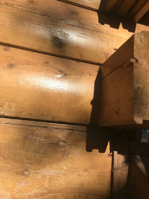

I would... a good question for your log supplier. Our cabin is built with D-Logs and sort of a tongue and groove. Pretty sure they used a sealant between the logs, and judging by the winter drafts not nearly enough! My SIL used both sealant and foam straps, also caulking the logs more for effect.
Here is a picture of the starter row log on our cabin... no flashing but they have always kept the logs and sub floor plywood edges well sealed. I would have flashed it. The logs are about 3/4" - 1" overhanging.
