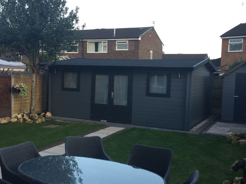

I would just like some advice on my bowing wall on one side of my log cabin.
It was installed by myself 1 year ago and I have noticed a significant bow on one side on the cabin. It was fully treated with Sadolin paint last year. Please see pictures attached.
I am not worried but would like a second opinion.

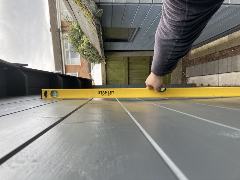

# Posted: 8 May 2021 10:56am
Hopefully it has stabilized at that.....but Id take some measurements using the long straightedge and make notes/diagram for future ref and checking (I forget too easy now).
