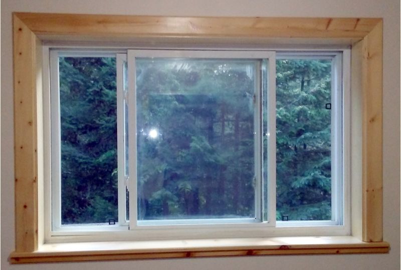

BTDT with a LOT of Red & White Pine T&G, as everything in my home is real wood. Even the outside is live edge white cedar.
I suggest a water based clear semi-gloss urethane. You can spray it (wear a mask!) but it is fickle. Most good ones can be recoated within 2 hours in normal 75F/22C temps. A light sanding between coats makes for a much better finish and you can use 300 grit sanding sponges which made it super easy. 3 coats actually does make the difference for a nice finish. BE CERTAIN to wipe off the wood after sanding to prevent any of the dust from mixing back in.

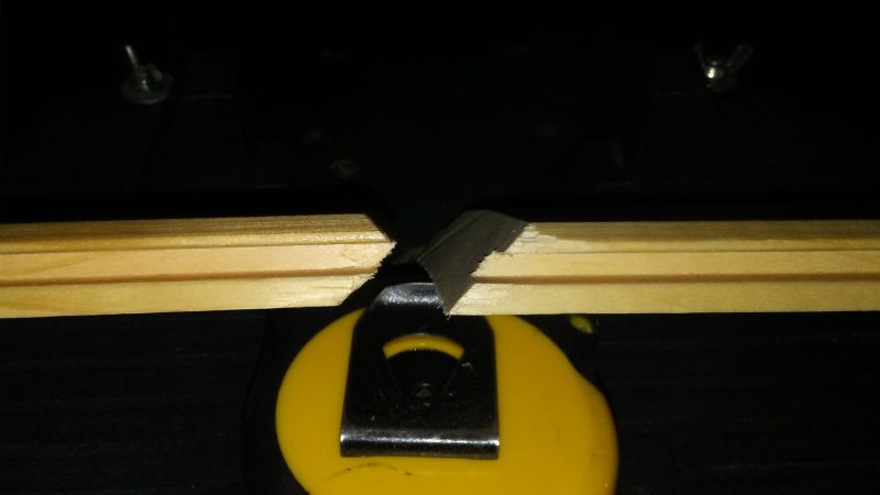

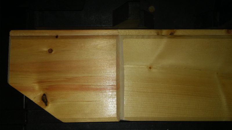

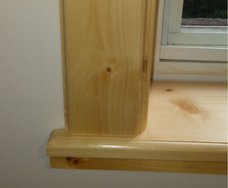

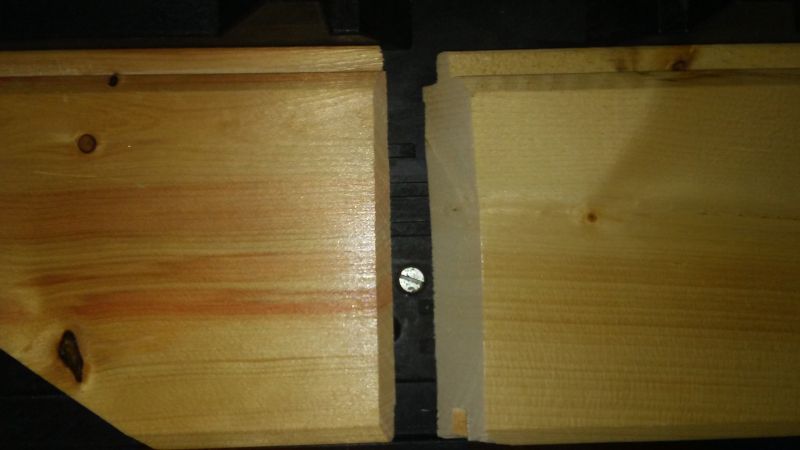

Finish everything FIRST before laying it up on the walls. Use a Brad Nailer and nail inside the grove of the tongue to hide the brad holes.
Bevel Cut your laps and do an overlap to hide the "butt" which will shift when expanding & contracting from humidity & temps. See photo's.
Hope it helps, Good Luck
Steve

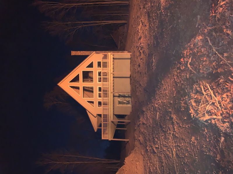

# Posted: 11 May 2021 11:28am
ndthand1992 beautiful place!! What's the cabin size? Do share more photos of your build...those of us who haven't built yet like to see build progress photos
ndthand1992
# Posted: 11 May 2021 11:37am

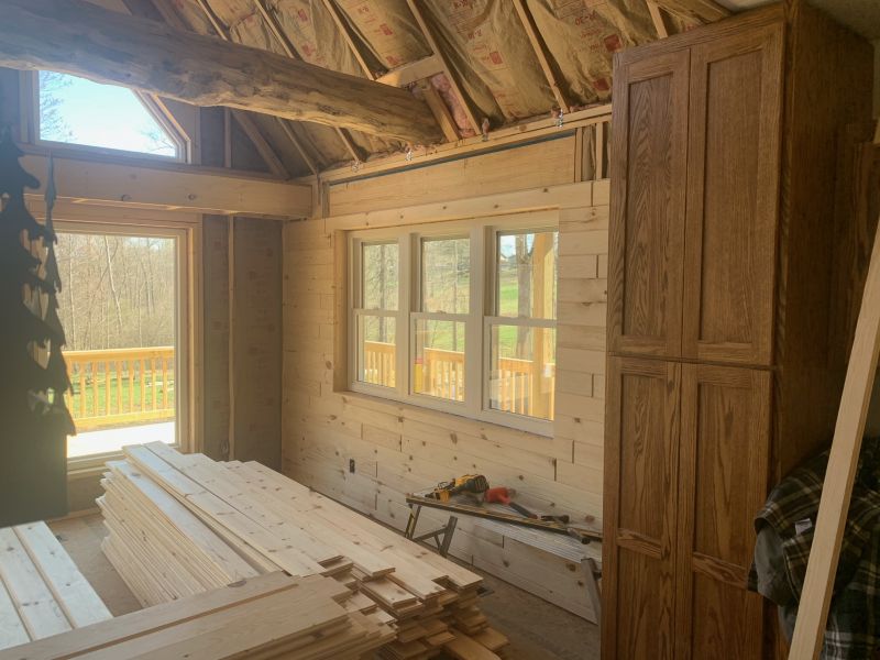

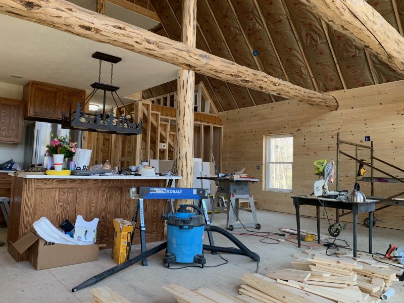

Thank you Willie , It is a 28' x 48' foot print with the ceiling height at 28' from the living room floor with a loft on a full basement. Roof has a 12/14 pitch. Semi A-Frame style.
Thank you Steve , I was worried about the bevel cuts which lead me to the decision to get the T&G "end matched" and I am completely pleased with. With the semi gloss urethane , do you notice any "yellowing" ?

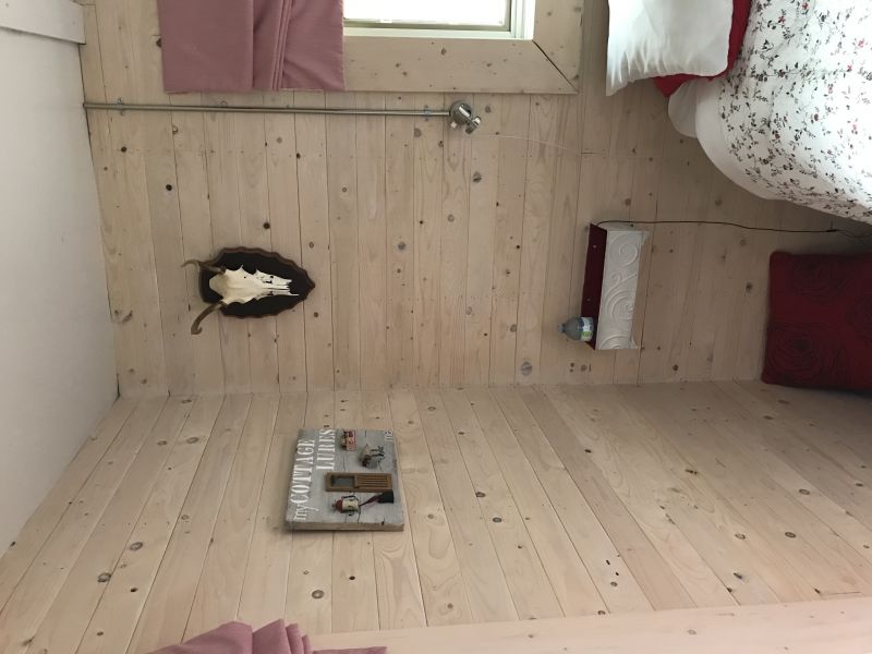

# Posted: 11 May 2021 11:45am
I would highly recommend you stain these boards before you put them up. It allows you to work like a human, on a bench and even get areas that you couldn't get when there installed
# Posted: 11 May 2021 11:46am
It’s a grey day here today but this should show it. Easy to wipe down for cleaning and still shows the wood

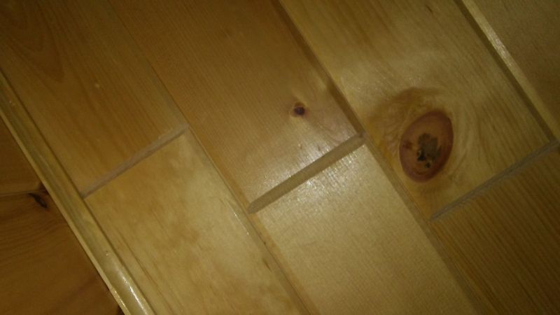

My builder used polycrylic. It has darkened very little. pics here.....
https://www.small-cabin.com/forum/6_6589_1.html#msg102253
