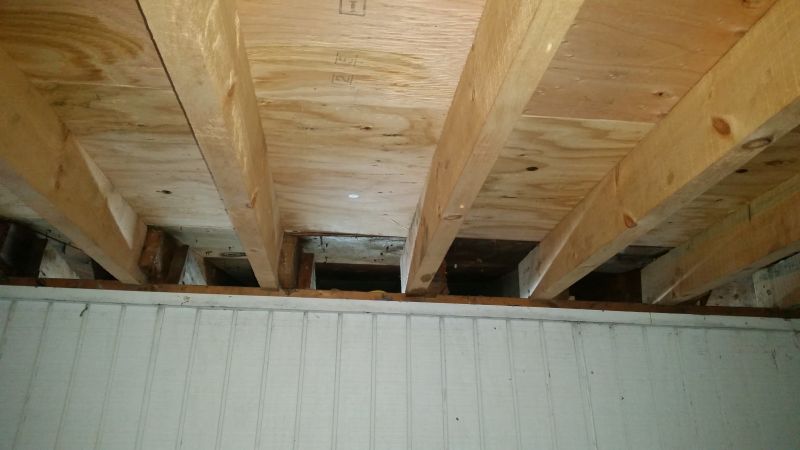

# Posted: 28 May 2021 05:46am
You just put the porch roof rafters over the cabin wall. In this case the cabin wall is the white T1 11 wall. You will need bird blocking and in your case vented blocking. Theres a spec on how much vent square inch is needed for a specific roof size and ridge vent style. The manufacturers website should have this.
