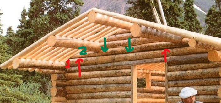

One thing that I am having trouble with is the interface of the gable logs between the eave logs and the purlins. I cannot seem to grasp how these two logs come together and are secured, as there are no notches and seem to be no braces on the interior.

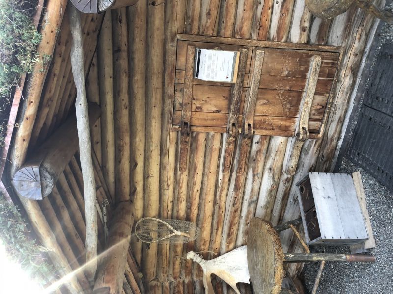

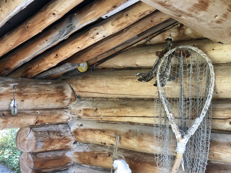

Here's some closer/clearer shots i took of the areas in question when i visited.

The wall logs I totally understand I am referring to the gable logs above the door. In the picture I attached, I am referring the first and second full logs over the door. The first is notched and over the eave logs near the #1 and red arrow. That much I understand.
However the log #2 (to me) seems to be just set on top of log #1. So hopefully to clarify, in my picture I would like some thoughts on how log #2 is secured to log #1.
Hopefully this is more clear? If not I apologize!

Your first picture actually shows clearly my question.
If you look at the Tang bottle it sits right at the joint of the two logs that I am confused on.
Log below the Tang bottle, notched and over the previous log. The log above the tang bottle seems to be just siting on the previous log with no attachment.

Pretty sure it's just spiked and pinched down with the large logs running perpendicular. He did alot of dowels as well so it could be those instead of or in addition to spikes. I don't recall if those logs specifically are shown in the videos or not.
