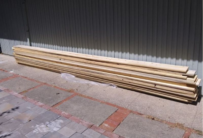

Thanks Steve. Well I went and got it after checking todays HD 1/2 plywood, $70! And with the pitched roof and eves I would need 8-4x6 pieces, so somewhere around $500.
Even if I don't use it, 1x12x16s are somewhere around $35 each, I'll find a use for it. I should only need half of what I got for the roof.

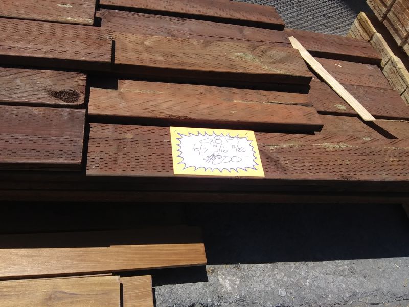

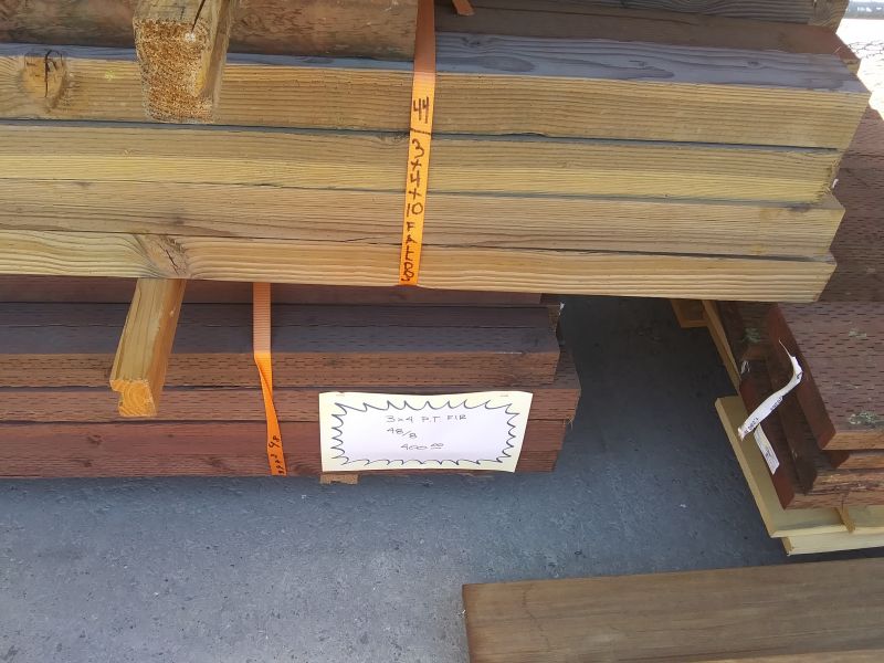

# Posted: 29 May 2021 06:10pm
Here's some of the other bundles they're selling

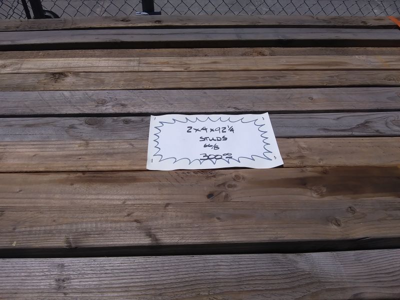

# Posted: 29 May 2021 09:43pm
Those studs aren't a bad deal either at $4.50, $8 at HD right now. Little old looking though. I don't need them at the moment but will probably regret it later, especially if this ridiculous market continues. If they were full 96" I'd probably bite.
