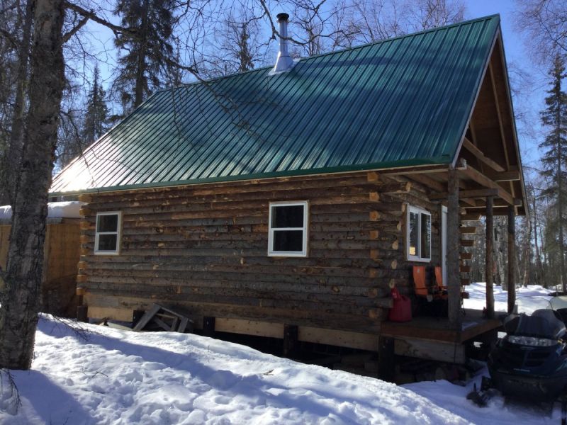

# Posted: 7 Jun 2021 11:02am
On our 3 sided log cabin. Our windows are framed with 2x8s. Windows are screwed to them. I used foam insulation, comes in a small roll . 3/4" wide 1/2" thick with a self adhesive on the back. Stuck on the window flange before installing. Then have fiberglass insulation around them. A 2" gap on top seems large for milled logs. On our cabin we used timberlock screws and had very little shrinkage. Less than 1/2" in 10' walls.
The outside trim will be fastened over the window flange to the Bailey box, window frame.
I don't have any pictures of the windows close up but maybe you can zoom in a bit on these.
Good luck on your build

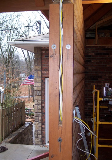

# Posted: 10 Jun 2021 08:53am - Edited by: Nobadays
Maybe pictures will help. The one showing wire routing also shows the slots/lags/washers as morock was explaining. The other picture is missing the slots but shows how the buck is framed.... although it is not the complete frame. As far as foam around the sides/bottom, yes and no.... the logs will move some so spray foam will likely crack. Better to use an elastic caulk and/or foam strips. My experience is that unless they are good dry logs you will likely have to go back in a year or so and touch up the caulking to get a good seal
But as AK said, you may not get much settling so the gap at the top may not need to be 2". We would only leave about 1" when constructing with dead, dry logs. Green logs are a crap shoot, I've seen a 4x8 picture window explode about a year after constructing the home with green spruce logs... with a 2" gap above that window! Your supplier will probably be able to help with how much gap to leave.

Thanks Nobadays, those visuals help. So everything get's tied to the buck and the buck needs to float (primarily in the vertical direction). The flexible seal (caulk) between the trim and the logs is what you need to rely on to keep the air out.
