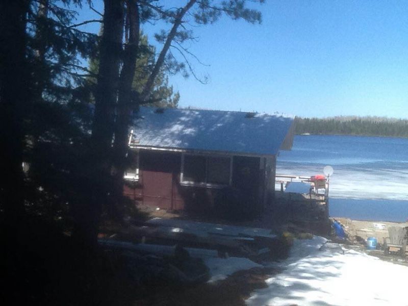

Going to be leveling a sagging corner in the cabin with bottle jacks. Any idea what size of jacks would be needed? I was thinking 12 ton but wondering if that will be enough to get the job done. The cabin measures about 20x35ft
matt112
# Posted: 16 Jun 2021 01:56pm
Here is a picture
# Posted: 16 Jun 2021 02:37pm
IF you are just renting one, get a 20-25 Ton unit and whatever you do, make sure it is on a solid "pad" so it doesn't sink. BTDT ! Ohh no fun !
IF you have anything big & heavy in the corner you want to lift, it's better to move it... If you don't and you hear creaks OR worse cracks, STOP !
DO NOT GET UNDER the cabin when on a Jack !
Do make a Pilon with criss crossed Large Lumber to slip under the rim in case the jack goes, so the cabin only drops an inch or so, just enough to save the cabin and your butt.
Murphy's Laws love to be applied to such adventures.
