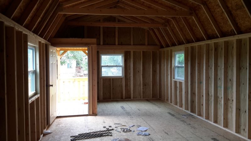

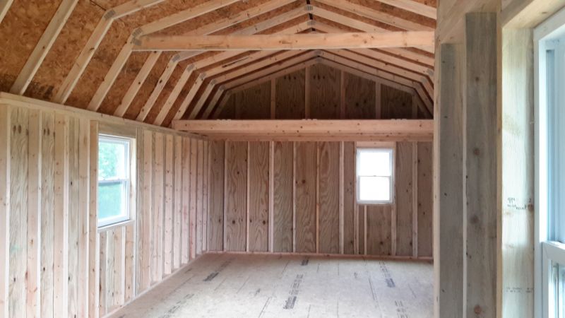

I had a 14' x 32' "shed" style cabin built for me as a 'caretaker' cabin for my mom. I'm trying to figure out the insulation for the vaulted barn shaped ceiling. The rafters are 2x4s and there are no gaps/venting at the eaves. At the ridge, the OSB does not meet and I can see the black paper that is between it and the metal roof ridge. The cabin is pretty air tight. been working on if for four years during weekend trips and have no mice/ insect invaders yet. I have read so many different things about vent channels, foam board, batting, foil, my head is about to explode from it all. The cabin is in southern Kansas and I will be heating with tiny wood burning stove and cooling with window unit. From all my research it sounds like I'm supposed to run 1x2 cross wise the rafters and fill in with 2" and 1/2" foam boards to have a 1" air space between the OSB and 2 1/2" foam board with a radiant barrier, sealed with tape on room side, then attach my finished ceiling material (probably tongue in groove)the the room side of the 1x2's, which will allow for 1" air gap between ceiling material and the radiant barrier. I attached two photos from before I started work. I've framed in a bathroom and closet at the end opposite door and have already installed electrical, plumbing, and wall insulation (faced Pink R13). Also, should I put some vents on the walls near the ridge on each end? I'm considering enclosing the end loft as a storage area. (excuse any bad terminology) Thanks for any advise and guidance!

Assuming you're keeping it vaulted, I think most on here would advise you spray foam it all and then attach your finished ceiling material directly to the rafter studs.

2x4 rafters and you still want an air gap? That really dosnt leave much if any for insulation. Have you thought about leaving the whole 2x4 for an air gap and putting foam board directly on the under side of the rafters?..then useing furring strips to hold the ceiling material on?

You can buy DIY spray foam kits, and if you're in southern KS, you might be able to make it go further. You could always do a layer of spray foam and then a second layer below it of foam board. One big advantage of spray foam is that is creates a tight seal.
