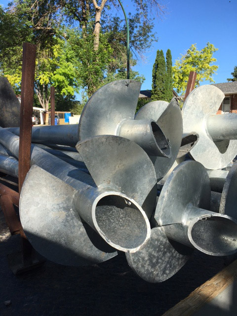

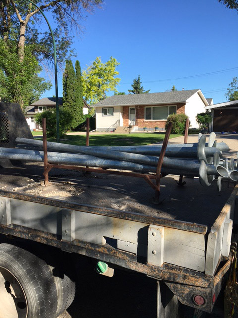

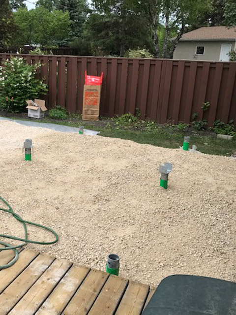

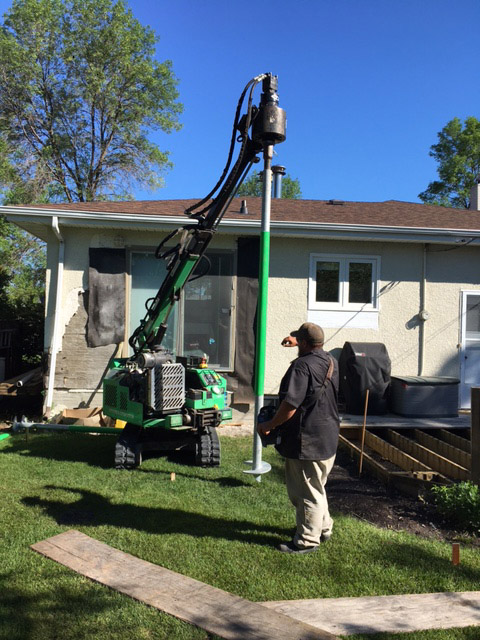

How about these helical piles my brother in Canada had installed for an addition. Manitoba has deep frost.

Geesh! That should be rock solid.
# Posted: 20 Jun 2021 10:18pm
Those will do well for sure, piles can be great but you hit big rocks where you need it, and .... well you can figure it out, LOL.
# Posted: 20 Jun 2021 10:26pm
You could drive an ocean liner with those things!

I used those under big grain bins. Fourteen under each bin ,six in. dia. And 16 feet long. Similar price to concrete base but will last hundred years.

What are they made of and coated with, and what's the green stuff?
# Posted: 21 Jun 2021 12:28am - Edited by: ICC
Steel of some kind. Stainless? Not sure I'll ask
Green is a plastic sleeve that prevents frozen ground from sticking and lifting the pile.
