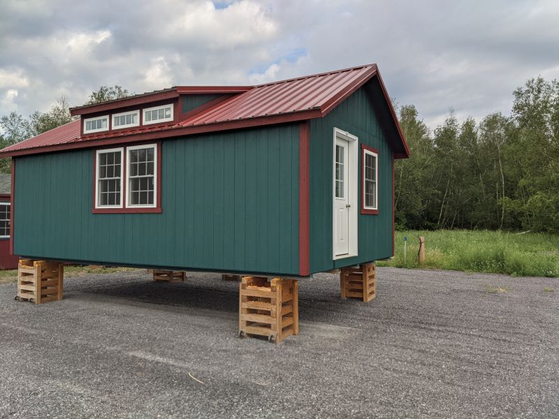

Pics, if it helps......

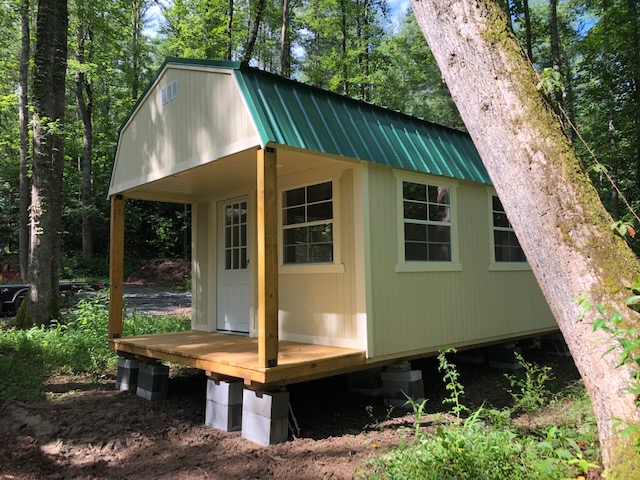

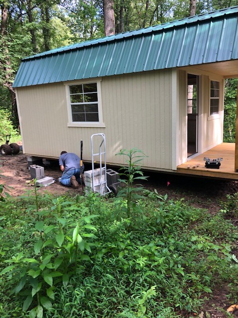

Like others, I don't see why not just have solid block dry stacked to the height you want just sit the skids on top. Its how ours is set. Not 30in but around 24in high. Then cabled down with auger anchors. I kind of seam like your adding skids to skids.
cabin
cabin
