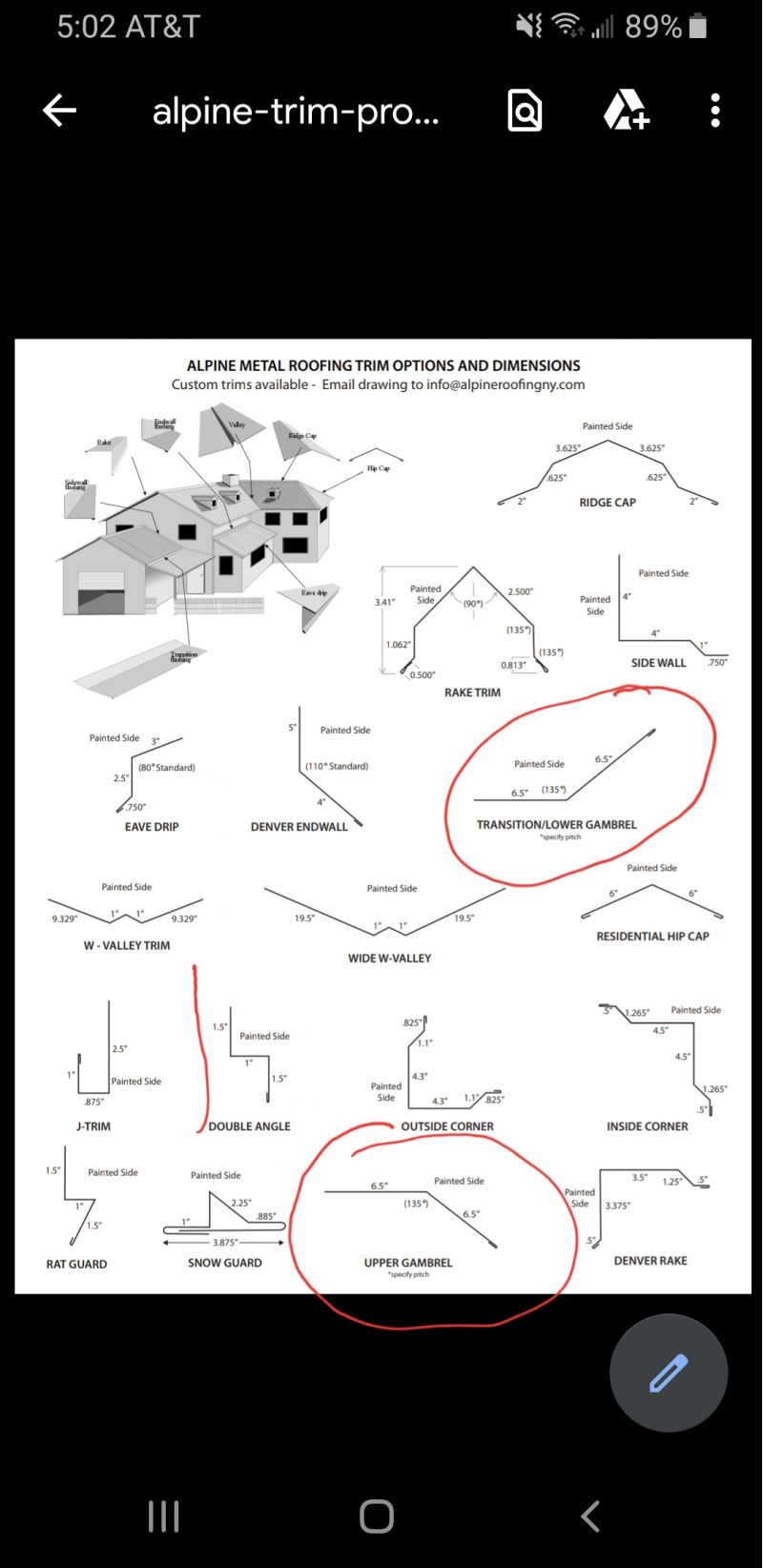

I would saw cut the bottom of your first log so it will accept a vertical piece of metal flashing. Also make the first log over hang the subfloor a bit.
Do you plan on skirting the under side? If so this is the time to plan that too. The metal flashing could be bent in a fashion to shed water along with leave room for the skirting material of your choice. Attempting to do this later means alot of work or relying on sealants for water proofing.
Even with vinyl siding you can tell when the installer didnt have acess to a siding brake. I wouldnt expect to find the specific metal flashing your looking for at a big box store if it has any bends in it. Really your best bet is prob a under side saw cut and to use coil stock with no bends exct at the corners.
But for refrence these are profiles for metal pannels. They are nice and thick and could be used for your needs.

I like your idea of a slight overhang. I could then take my Dremel multi saw and use the edge of the subfloor/rim board as a guide to put a nice thin slit into the bottom side of the log for the coil stock to slide up into!
