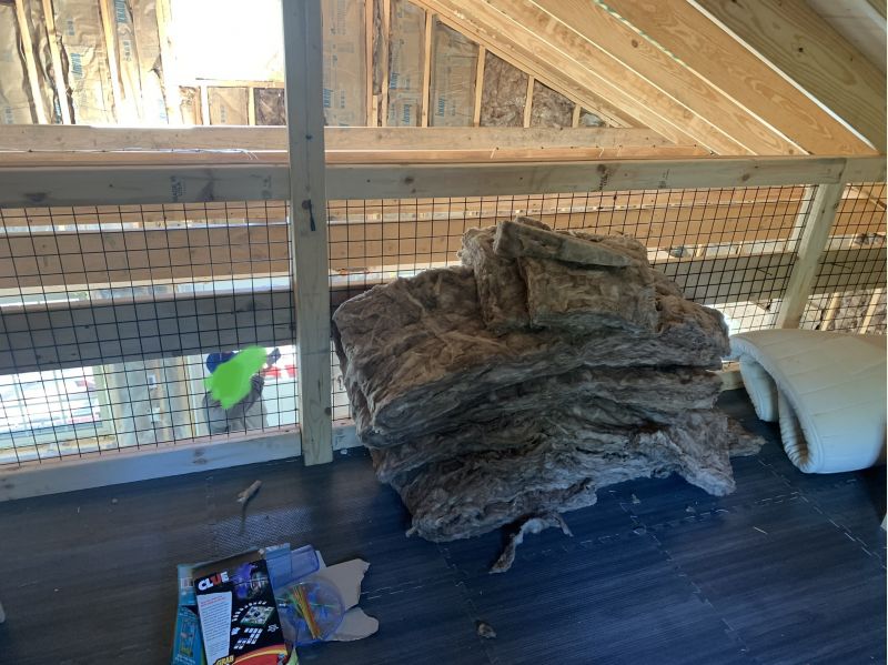

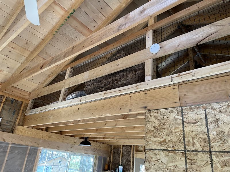

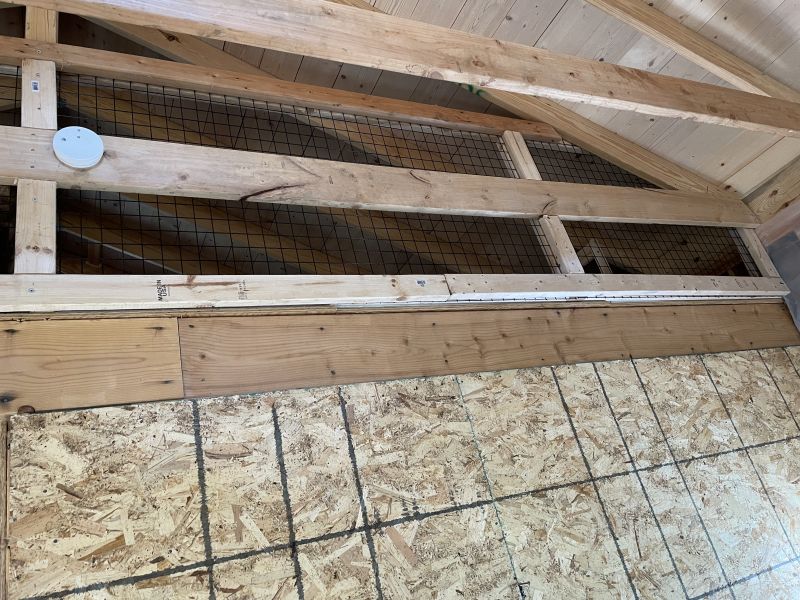

Finished my railing this weekend.
Here’s what I went with. Nice black Welded wire panels sandwiched between 2x4s. 2” square pattern.
I used the rafter tie in the middle as support as well as a post from the ridge down as a center support, then another 14 ft 2x4 across the top spaxxed into the rafters. I pieced the rest in with 2x4s. I spaxxed the bottom 2x4s into the joists of the floor.
I am very happy with it!

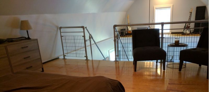

We are toying with the idea of a barn look on the outside and super modern on the inside (an interesting juxtaposition as you cross the doorway).
Anyway.. We are thinking along a similar line as you (hogwire), but with metal railing. Kinda like this picture.

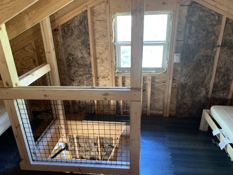

# Posted: 18 Oct 2021 10:24am
Found some better pics from inside loft. Couldn’t previous post…

# Posted: 18 Oct 2021 10:27am
Quoting: travellerw
I like that! How do you secure the railing? Is it just galvanized 1/2pipe with a foot/flange screwed into the floor?
travellerw
# Posted: 18 Oct 2021 12:59pm
Quoting: Grizzlyman
Its more than 1/2" pipe in that photo. I think that is 1 1/2" pipe.. and Yup, just a foot flange bolted to the floor!
