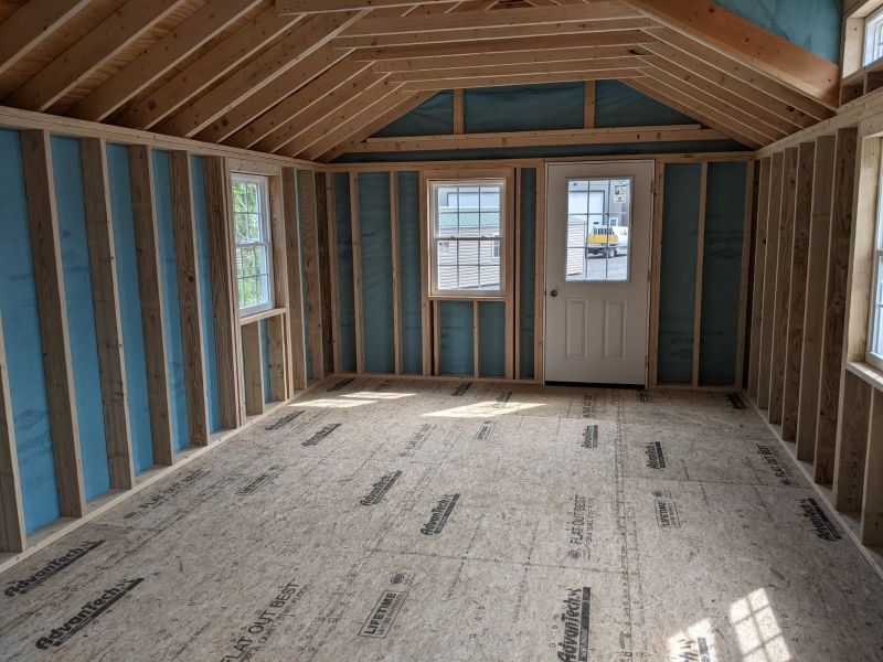

I took delivery of my 14’ 24’ off-grid, 3-season cabin last week. I’ll use a wood stove for heat and there’s 2” of closed cell foam in floor. I have 2x6 studs and rafters and plan to install 5 ½" Rock Wool insulation in both. It's a catheddral ceiling. Can I get away with not installing roof baffles? If not, I guess I’ll extend the rafters with 2x4s cut in half. Suggestions will be appreciated. Thanks.

Are there vents in place, and do you plan to install ridge and soffit vents if there are none?

There's a ridge vent but no soffit vent. I can add soffit vents....

If you have soffit and roof vents they need to be screened, Id want something good enough for insect and mice.
Then there needs to be the air movement space above the insulation. If the insul goes all the way to the underside of the roof deck you will need the baffels. If you leave an inch or so clear of the deck you shouldnt need the baffles?

A ridge vent also has a spec on how much opening needs to be at the sofit. Look this up before proceeding. Yes space down the rafters by cutting a 2x4 in half..or buying 2x2s

Thank you for all the advice. I decided to vent the ceiling. There's already a ridge vent and I'll add two 4" round soffit vents to each bay, cut 2x4s in half and attach to bottom of 2x6 rafters to increase the amount of space so when I add 5.5" of Rockwool insulation there's a gap between the top of the insulation and bottom of plywood roof sheathing. The cost is about $350 and a day or two of my time, good investments in case I use the cabin, in the Adirondacks, more during the winter than I originally plan to.

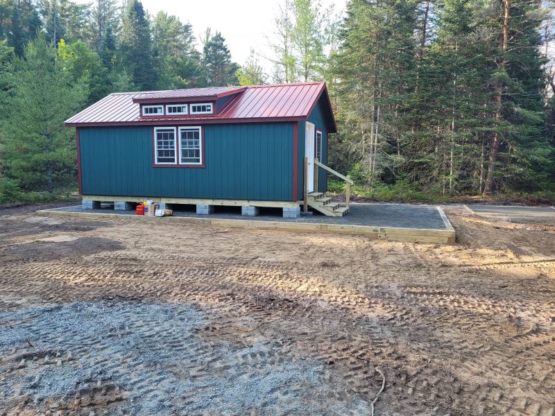

Yes, exterior is complete. This is a pre-fab shell that was trailered to our site.

Exterior complete:
# Posted: 27 Jul 2021 10:31am
Nice cabin Geobuild. Do you plan on staining the skids or putting gutters on? That also looks like some nice loose soil around it, perfect to rake some grass seed into.
# Posted: 27 Jul 2021 10:39am
Nice!
I second the gutters, think you need to get that roof water away from your 'pad'.
Also recommend doing a rain barrel (or 2) with a 'first flush diverter' set up. Lots of great info online. Our place is off-grid and dry, the pickle barrel has been easily supplying all our utility water for the past 2 summers.

# Posted: 27 Jul 2021 12:00pm
Thanks Brettny & gcrank1! I plan on gutters this fall and then collect the rainfall. I have 4 garbage cans under the eaves right now for water for general use. Foundation skirting next summer along with on-ground solar panels and batteries. I'm using an Ecoflow Delta 1300 power station right now for basic electricity and recharging with my generator. Takes less than an hour to go from a low charge to 100%!
The wife hasn't been to the cabin yet..... this Monday and she's going to deal with grass and wildflower seeding.
