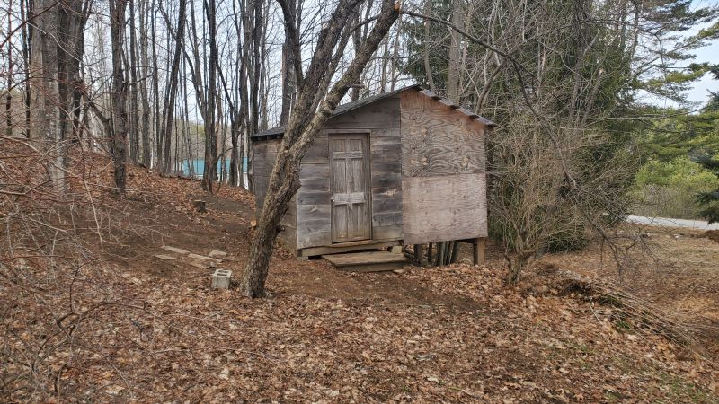

We bought a house in NH that had a really lame chicken coop on the property. The location was bad so I built a coop for my wife in another location. I decided to turn the original coop into a wood turning shop but the further along I got I couldn't help but envision it as a quiet study cave.
I increased the pitch of the roof, knocked out the middle wall, and added 6ft additional space on the back end.

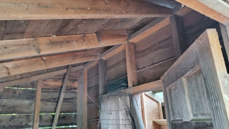

Here is my question (and you can see in the pictures). The original walls were oak planks (not tongue and groove) and you could see outside in-between them.

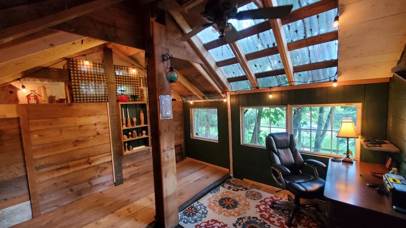

'I wrapped the whole cabin in tyvex and sheethed with smart siding (like t1-11). On the inside I tyvexed everything and then used oak planks (not tongue and groove) over top. So, there is no insulation in the walls at all.
My question is...how do I keep the humidity low? Do I just put a couple gable vents near each peak? There are no real soffits and the open air is bringing lots of humidity inside. I read elsewhere that the soffits need to be closed off so a dehumidifier or AC could bring humidity down.

As it was when we got it

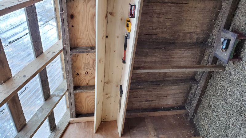

The middle wall and see through exterior
where I am at now
where I am at now
# Posted: 28 Jul 2021 11:18am
Gable vents are for attics. If you want to lower humidity, you don't need more outside vents. Once you have all the air leaks sealed, use a dehumidifier plumbed to the outside.
