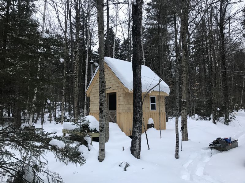

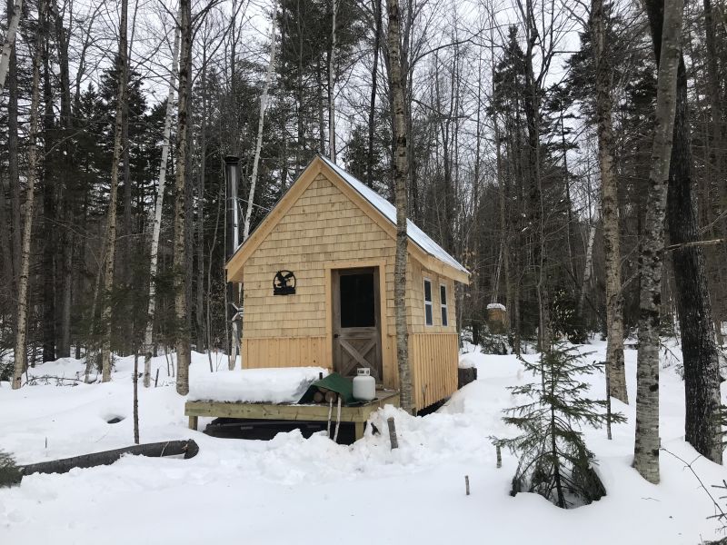

I've got a 12/12 pitch metal roof and sometimes it sheds snow, other times not... It will depend on temperature and type of snowfall. A mix of snow/rain, freezing rain to snow or a heavy wet snow will likely not shed. Also depends on how well roof is insulated and warmth from below. Upon arrival to my place back in February in VT, I had over a foot on the roof. A couple days later with the woodstove going and fluctuating outside temps it finally broke loose.

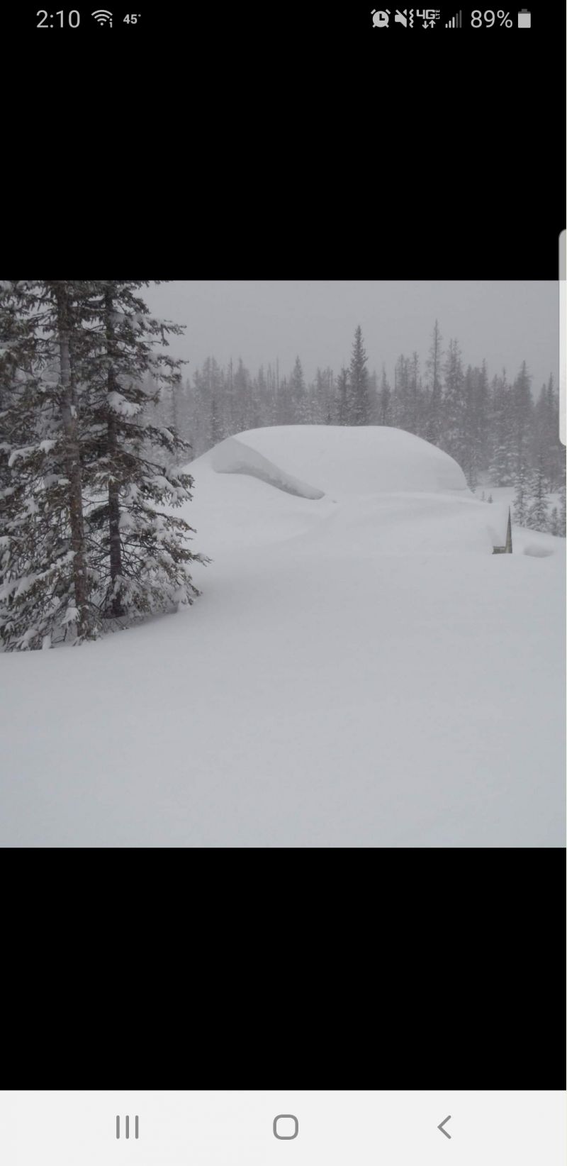

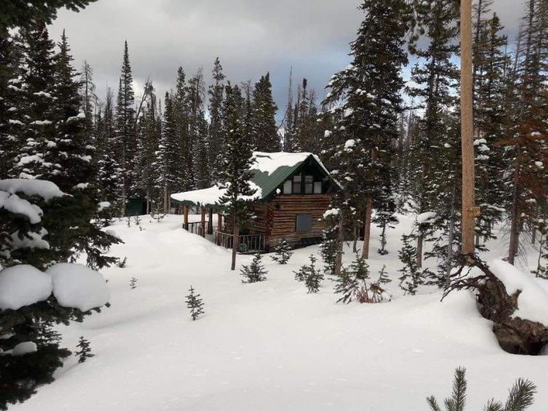

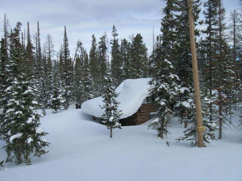

I really don't use my cabin in the winter, but according to neighbors...snow will accumulate all winter during the real cold months until the sun's energy is sufficient to create some melting on top of the meatal to provide a lubricant to break the bond of snow and metal. Then the snow will shead. The first three are of a neighbors place to show the snow loading over the winter.
In my area, when the snow gets above 15 feet, there is nowhere for the snow to go from the roof, so it just stays there...
