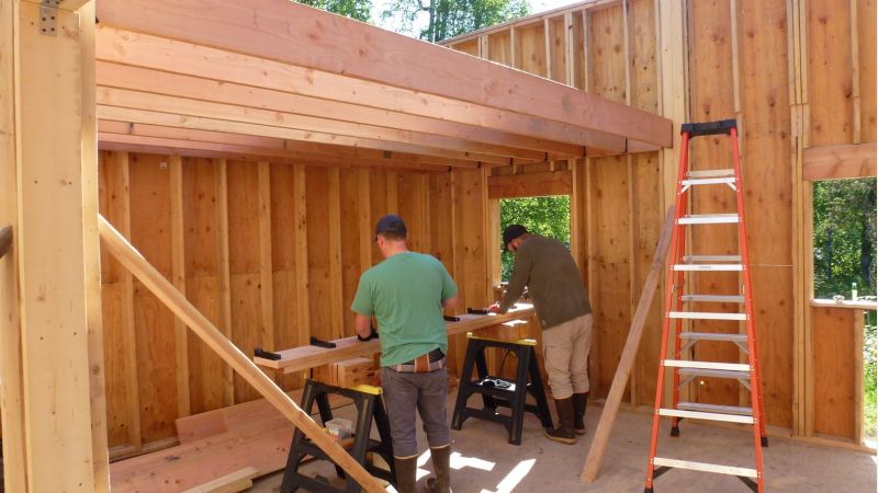

16x30 cabin with 10' deep by 16' wide loft on either ends. Lofts will be for sleeping only and will only have a bed and maybe a small dresser. The WI construction standard calls for 40/10 live and dead loads and L/360 deflection for FLOOR joist. Since this is a loft, i think the specs for "ceiling joist w/ attic storage" would be sufficient. The specs for that are 20/10 L/240.
Using the span calc. using SPF lumber it calls for a 2x8 w/ 16"OC to make that 16' span. Original thought was to run all the loft joist in the 16' direction. But then i saw North Rick's method where he ran one loft joist across the width of the cabin and the rest perpendicular to it since that distance was shorter. So if i followed his concept where the 1 joist at the open end of the loft ran the 16' direction and then the rest ran the 10' direction, how do i calculate what i need for that 16' board since it will now carry the load of all those 10' joist? Is there a span calculator that works for sistering of joist or for doing built up beams?
I like this option because i feel like it would save on how much lumber i need. However, i do not want a support pole going to the 1st floor and i'd prefer not to have to go up in lumber size from a 2x8.
