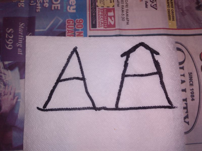

Here's an idea that popped into my head after reading your post.
Maybe you could make a funky modified rafter/wall like the one in the high tech drawing below.
It would give you more useable space, and a bit more headroom. Never seen it done. But I don't know why it couldn't be done. You may have to add a beam splitting the loft since you have a big snow load up there. Or even a steel bar across that would prevent the sides from pushing out. I'm sure ICC and a few others could figure out if it would work.
Sharpie/Napkin design
# Posted: 13 Aug 2021 05:30am
An A frame is prety poor use of space in any size. The area by the wall is almost useless or your forced to build cabinets there. I would start by useing an A frame calculator(rafter calculator and really figuring out how much room you will really be with.
What size and length rafters can you get?
