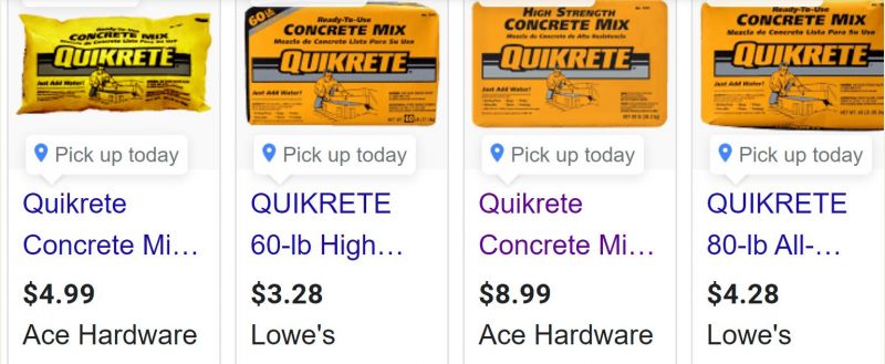

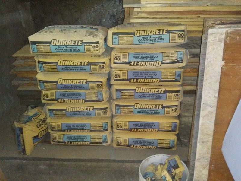

Last night while walking the dog by the school behind my city house, where they are finishing some construction work, I noticed a pallet with sacks of Quickcrete next to the dumpster. On this morning's walk I asked about it. Take it! 15 80lb. sacks. Do I need Quickcrete at the moment? No. Am I a scrounger? Probably.
So I got back, looked up Quickcrete, only about 4 bucks a bag, wouldn't even cover the chiropractor copay. Then I noticed this is 'Extra Strength' Quickcrete, closer to 10 bucks a bag. That's better..
So, what's the dif?

# Posted: 17 Aug 2021 02:20pm - Edited by: ICC
What is the product number on the bag?
Never mind that, I see the same number of different size bags. What's with that?
How or where do you get the higher price you quoted is a better question I think
# Posted: 17 Aug 2021 02:26pm
1101. High strength, not extra strength
# Posted: 17 Aug 2021 02:29pm
How many PSI is listed on the bag?
# Posted: 17 Aug 2021 02:32pm
1101 should be listed as 4000 PSI. Nothing special about it
# Posted: 17 Aug 2021 02:37pm
Sometimes the bags of 1101 include the wording "high strength" and sometimes they don't. Different plants I guess. According to Quikrete all 1101 are 4000 PSI and even on their webpages they use different labeling on 1101
https://www.quikrete.com/productlines/concretemix.asp
https://www.quikrete.com/pdfs/data_sheet-concrete%20mix%201101.pdf
# Posted: 17 Aug 2021 02:43pm
Here
# Posted: 17 Aug 2021 02:46pm
Looks like maybe it just costs more at Ace.

# Posted: 20 Oct 2021 08:23pm
Well I checked the bags today, still loose but it's mighty humid in this rain. They are dry in my shop but I'm thinking maybe a bucket of desiccant and a tarp over it?
I do have plans for it but might have to wait out the winter.
