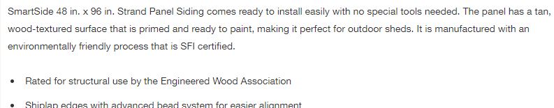

Also, it says SmartSide is structurally rated.
Yes some of their panels are structurally rated. Not all. It is code approved for building residences in the manner illustrated.
That does not make it a really good construction method. The 4x8 panels have their place, IMO, for sheds, barns.... As you noticed, when it comes to installing windows and doors a single layer wall like the 4x8 smartside panels gets to be more troublesome than traditional stick building where the wall structure is first sheathed. Then weather protected with much better weather-proofing, then a final covering which is mostly cosmetic.

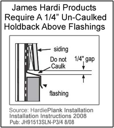

The most common Z-flashing error is to have the bottom edge of the upper panel resting on the metal. The must be a free gap and no caulk in the space.
z-flash
z-flash
This is prob what happen. The place was about 15yrs old before I bought it so not totally sure. Either way if you put a 1x3 around the seam for a "trim board" it's going to rot behind it no matter how much you cawlk, paint it. The same is happening above my garage door trim. Having at least 12in gabel end over hangs really helps, something this siding didnt have for 20yrs. T1-11 is also nearly impossible to scrape and repaint so pick your coatings on how easy it is to re apply..stain it.
