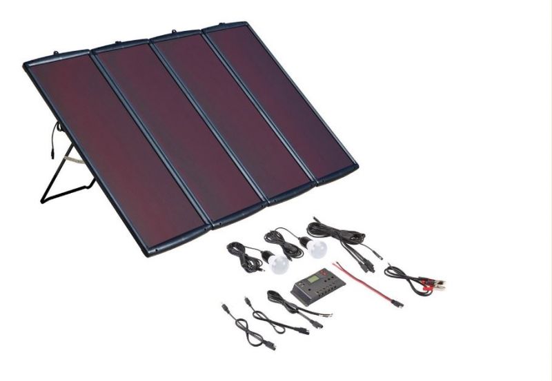

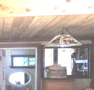

Well, I took one of the 12v LED bulbs that came with my old HF solar kit and screwed it into a 120 lamp, connected to 12v. It's our main overhead light.
If that helps..
