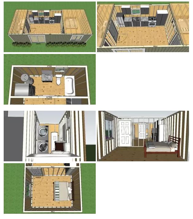

Here are the plans we are using. We have modified the dimensions (12x16), added a few windows, and upgraded to 2x6 framing.

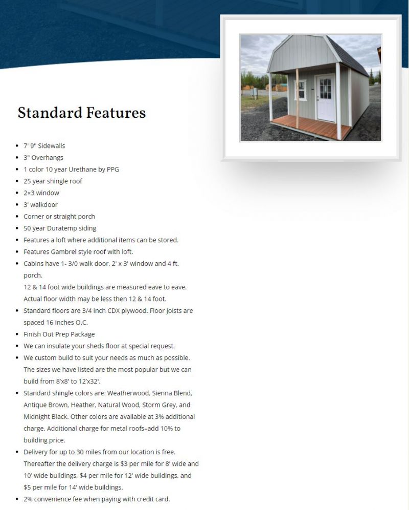

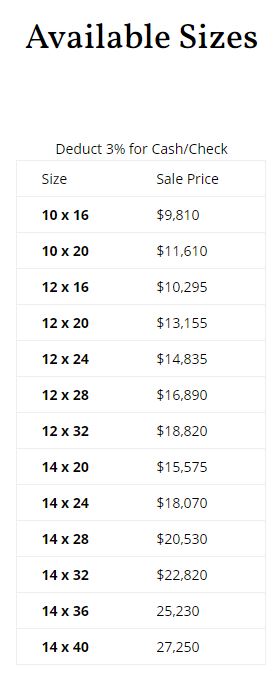

After thinking about it some more, I think you may be able to find someone to build this offsite and have it delivered for a far better value. I just noticed the note that you have already spent $13,000 in site prep. I would imagine that work would allow you to bring in one of these units quite easily if you have a company in your area that provides them.
We have a company that cranks these out locally, that basically builds them to the same specs - with additional options, for farrrr cheaper.
When I looked at this option for my place it was only going to be $120 to have it delivered. If your place is easily road accessible like you say this may be a better route to take.
Photos to provide some ideas/comparison. Keep in mind this will be cheaper because they are building offsite in a warehouse, however the end product is likely very similar to what you are proposing.

There are many many "shed" companies who can basicly build the same thing for far cheaper and have it dropped off. They can build to your spec meaning you can spec every window, wall stud dimensions and even have it insulated prior to dropping off.
